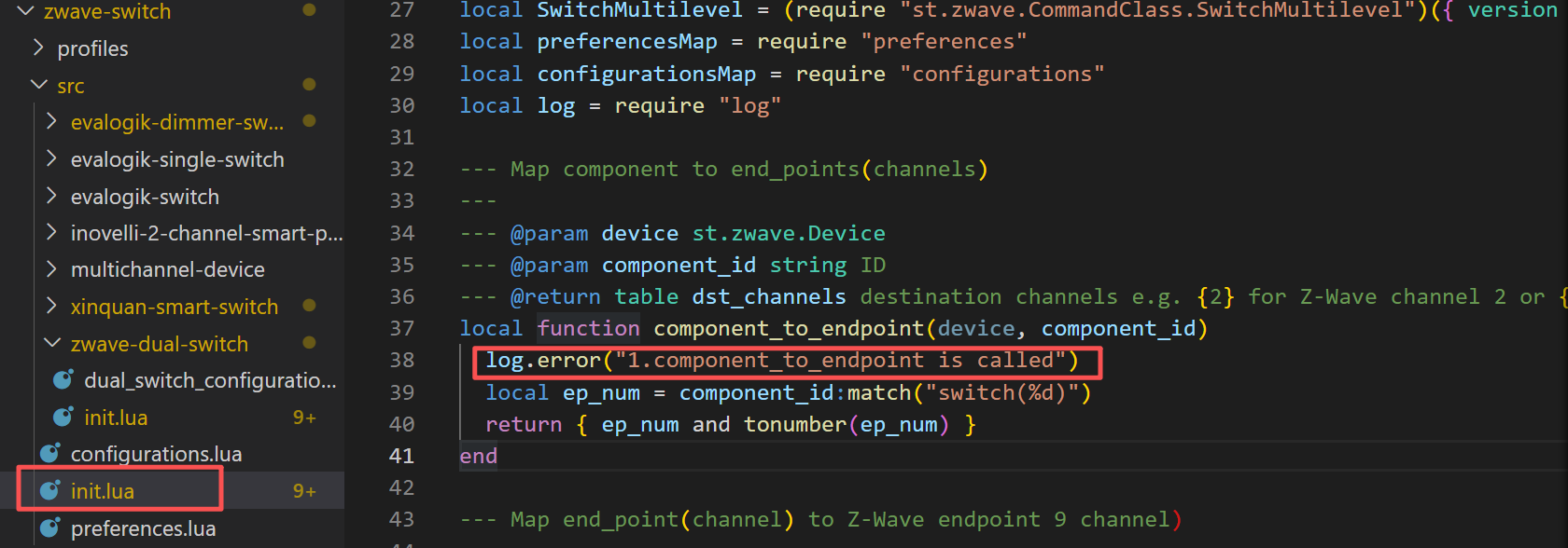

I have traced the wrong as your guide:
Here, I add logs in every functions as below:
And here, I add logs in every functions as below:

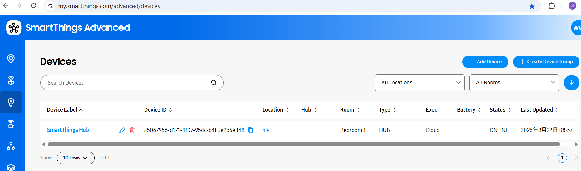

In order to reduce unwanted logs, I deleted all devices:
Get the SmartThings Hub Local IP Address:
