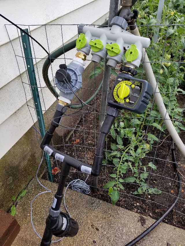

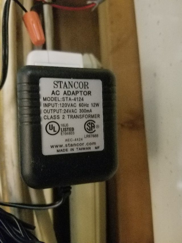

[image: veg manifold1.jpg][image: veg ps1.jpg]Yes. Standard 24V valve. I
also wanted to be able to initiate a water cycle if i was in the yard with
no phone so I rigged up a manifold.
Is there somewhere you recommend to get the adapter from? A local store you went to perhaps? I’m guessing you just cut the end off the adapter and wired it direct to the valve?
Yep. Wired it to the valve.
I just did a search on amazon for the PS that i used.
Just remember that the output of the PS is AC not DC
24VAC @ 300 mA.
The 300 mA was right for the valve that I got. I called the valve mfg and
asked for the mA range that i could use and the 300 mA fit. I don’t
remember the range though.

Yes. Its pretty easy actually. The problem was figuring out how to connect a hose bib on the house to the sprinkler controller. I figured it out. Basically hooking up a inline sprinkler control valve with an adapter and running new irrigation wire to the controller. I did a test run hooking directly to a hose and it worked great. I hope to complete it in the next few weeks.
Hi there. Did you manage to get this to work? I’m doing the exactly same thing but I’m planing to tie it to Sonoff Wifi LV safe switch which once powered (up to 24V) can pass the current to the valve, which sounds like a dream in this case. We’ll see if it works. I got the valve already so now I’m just waiting for the switch.
Yeah, it works great. I just got it set up for it’s sophomore season.
