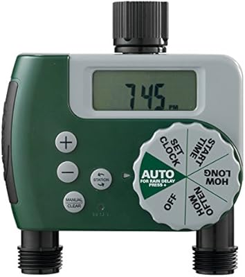

pretty much any battery-powered hose timer will take a manual request to water for a short time.
I use a couple of the Orbit 2-outlet timers. Press the “manual” button once and it turns on the last outlet for 10 minutes. Press the “minus” button until you get 2 minutes.
I don’t know if you can save “2 minutes” default - probably not.
Drain them, shake them, and ventilate them, before you put them away, and they have lasted me 4-5 years so far.
