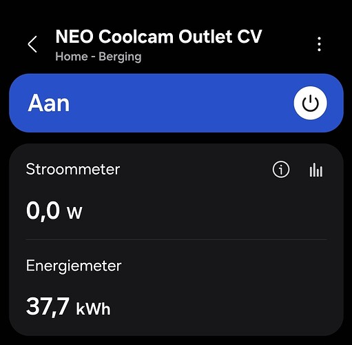

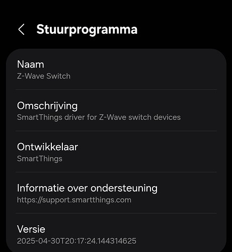

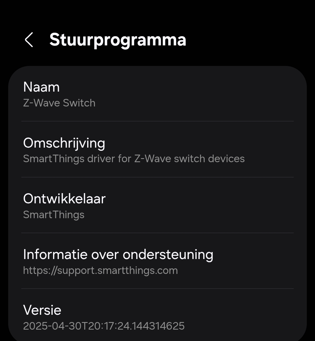

I have a CoolCam Zwave energy socket with the “Z-Wave Switch” driver and it shows power (Watt) and energy consumption (kWh).
Have you tried that one?
PS need a Z-Wave tool to reset energymeter (RESET_METER).
