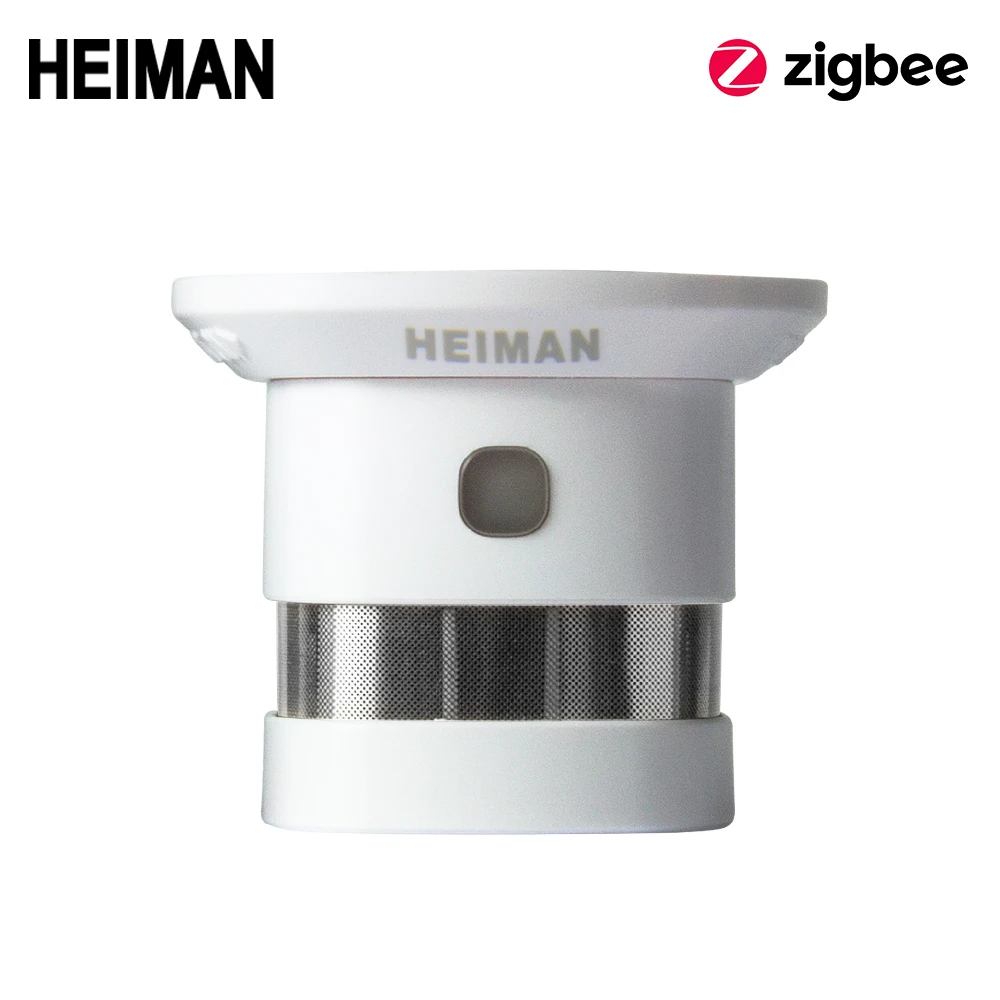

Reviving an old thread… Have added the smoke detector, changed it to the stock handler. The sensor comes as online and after few hours goes offline. The battery always shows as 0%. Anyone else experiencing this? Any custom DTH that is current and works?
Hi @sidk,
Wath is the model and manufacturer?
I installed 3 heiman zigbee model (HS1SA-E) that have different fingerprint that model (HS1SA-E) in stock dth “Zigbee Smoke Sensor”.
I added the fingerprint and works well since 6 month ago.
Added Runlocally and show local in IDE
The model is HS1SA-E
  • application: 11
  • endpointId: 01
  • manufacturer: HEIMAN
  • model: SmokeSensor-EF-3.0
Changed to your code, made no difference. Pressed the test button, came back online, but still shows as Battery 0%.
Yes, is the same model of mine.
Now that you have the modified dth published, did you try deleting the device and pairing it again?
I think i remember i did that
Hmm, no I didn’t do that, just updated the DTH. Will try to delete the device and re-add later today.
Forgot to reply here @Mariano_Colmenarejo , I deleted the dece and paired again. Your code works like a charm. Thank you so much.
