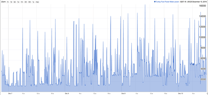

I’ve been logging for a few days.

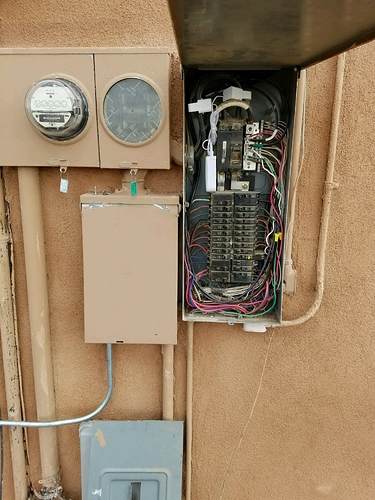

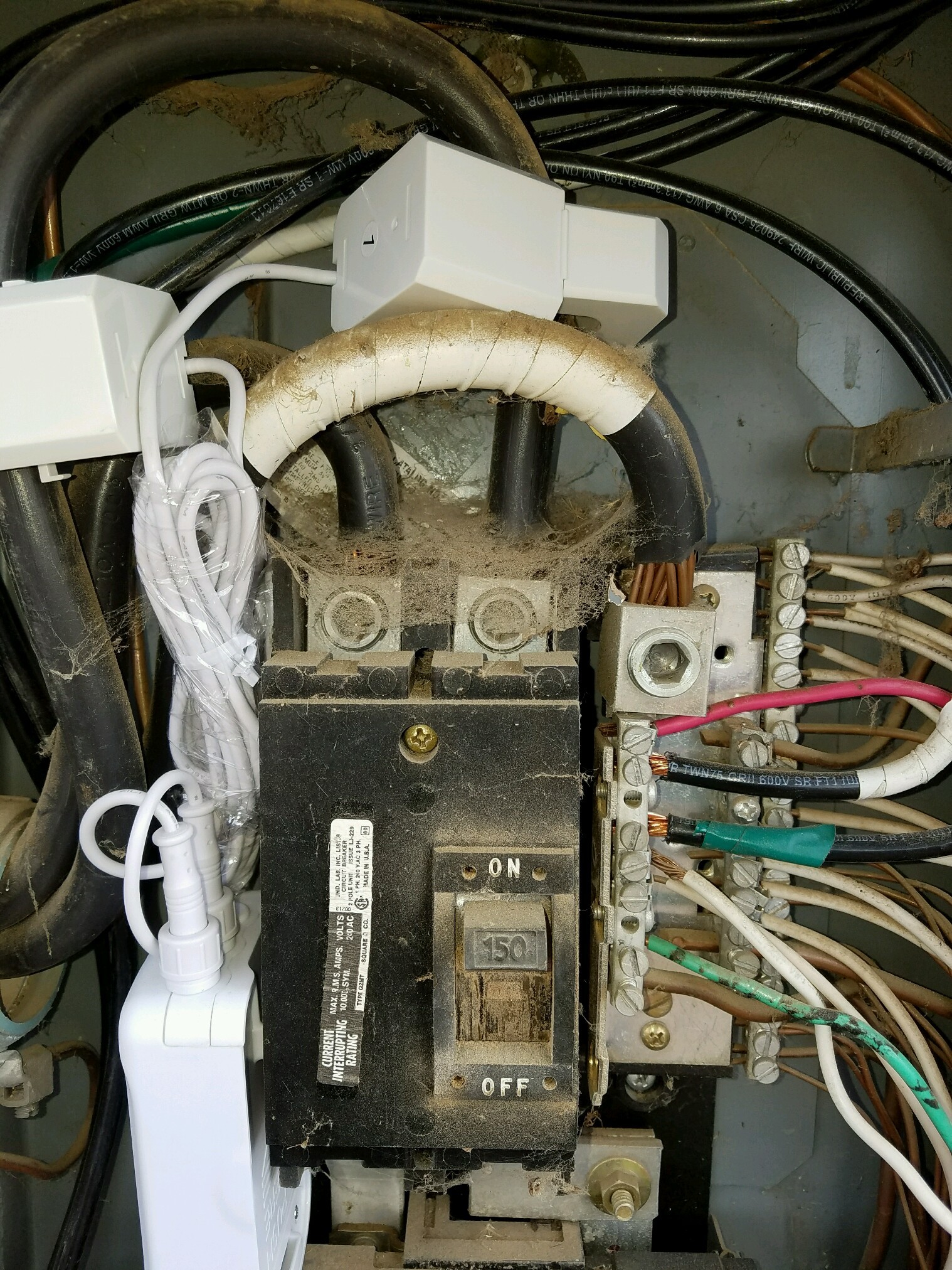

SO I have no choice but to use batteries and my box is outside and there is no plug to go into. So I have to wait to get an update. To be honest not even sure that I can see the device after I put the cover on it. Is there anyway to see if my system can still see my device or do I have to wait to see if it ever reports. I also have a weird configuration in my box. I have 600 amp service at least that what the cables say. I have to main feeds coming into a 150 amp breaker and another feed coming into the main circuit box without the breaker.
None of that makes any sense. I would not worry about what is printed on the cables, it’s the breaker that’s important. Can you post a pic? Maybe the one that bypasses the breaker is the ground?
I’m wondering the same thing. I have ben playing around. I turned off my furnace, water heater, every light inside and out, the TV, still over 600 watts reported being consumed. Yesterday I got it down to 270 watts without having to trip all the breakers.
