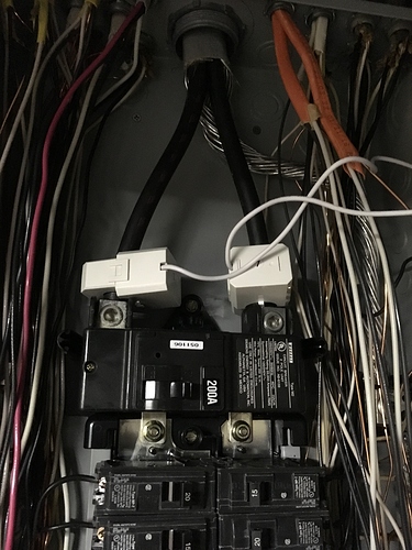

I had shots of dryer and stove but can’t find them. Split the cable down enough to clamp both hots, pretty easy.

Is there any reason why you wanted it inside the switch box? I plan on clamping it to the incoming wire on top of the box. Looks like your wires might come from behind. It’s hard to tell from the picture. If so, the I guess I know the reason. . . .
That is indeed the reason. :slight_smile:

Just need to find a way to pull those cable nicely through the electrical panel…
Punch out one of the knock outs and feed thru there. Add a 2-screw connector and shim way out with “something”. Could use fireproof foam or caulk as well.
Could use a smaller cord clamp but would need to drill the cabinet.
The electrical panel is recessed inside the wall, I could pull the cable through it but will still end up in the wall.
I have an electrical outlet 3 feet below, I may need to fish the cables out to the outlet… that’s not perfect but I can’t think of anything else…
Definitely need to spay foam in there, I can feel the cold going in! probably from the main cables…
Just installed mine:
Lots and lots of room in my box, so installation was very easy. I just opened a knockout on the side and put a cable clamp in and that was that.
