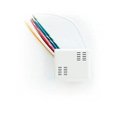

What most people are doing is getting an in wall micro relay that can control two branches And then wiring it to any momentary dual switch you like. That should work fine, and there are number of community members doing it. The vision micro is popular because it’s quite inexpensive, but there are a couple of other brands as well.
Just check the specs carefully to make sure they match what you are wiring it to.
This link is to a two pack, but you should be able to find individually as well:

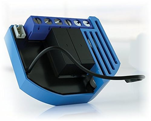

Qubino also makes one which has more features and is smaller, but it also costs more,

Vision relays will do exactly that. Existing switch controls relay directly, no HUB involved. Or automation controls relay through HUB.
Also you could by 2-pack and save a few bucks. Vision - The Smartest House
I bought the Vision In Wall Z-Wave Micro Switch, 2 relay (2pack). Installed one the drive 2 switches. It was very easy to install. Easy to configure. It’s small but I needed to more wires around as my box has many wires, Pushed it onto one of the corners and it’s happy where it is.
