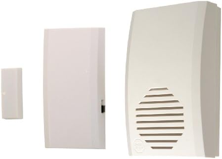

Or if youâre willing to spend about $50 for the nonnetworked device you can get the three part kind that stores like Subway use. These let you put the part that plays the chime anywhere you want. There are many of these sold for stores and offices, usually called âentry alertsâ or âvisitor alerts.â The following is just one typical example:
Again, with this method the device that plays the sound is NOT connected to your SmartThings network, you add a second networked door sensor so ST also knows the door is open.
