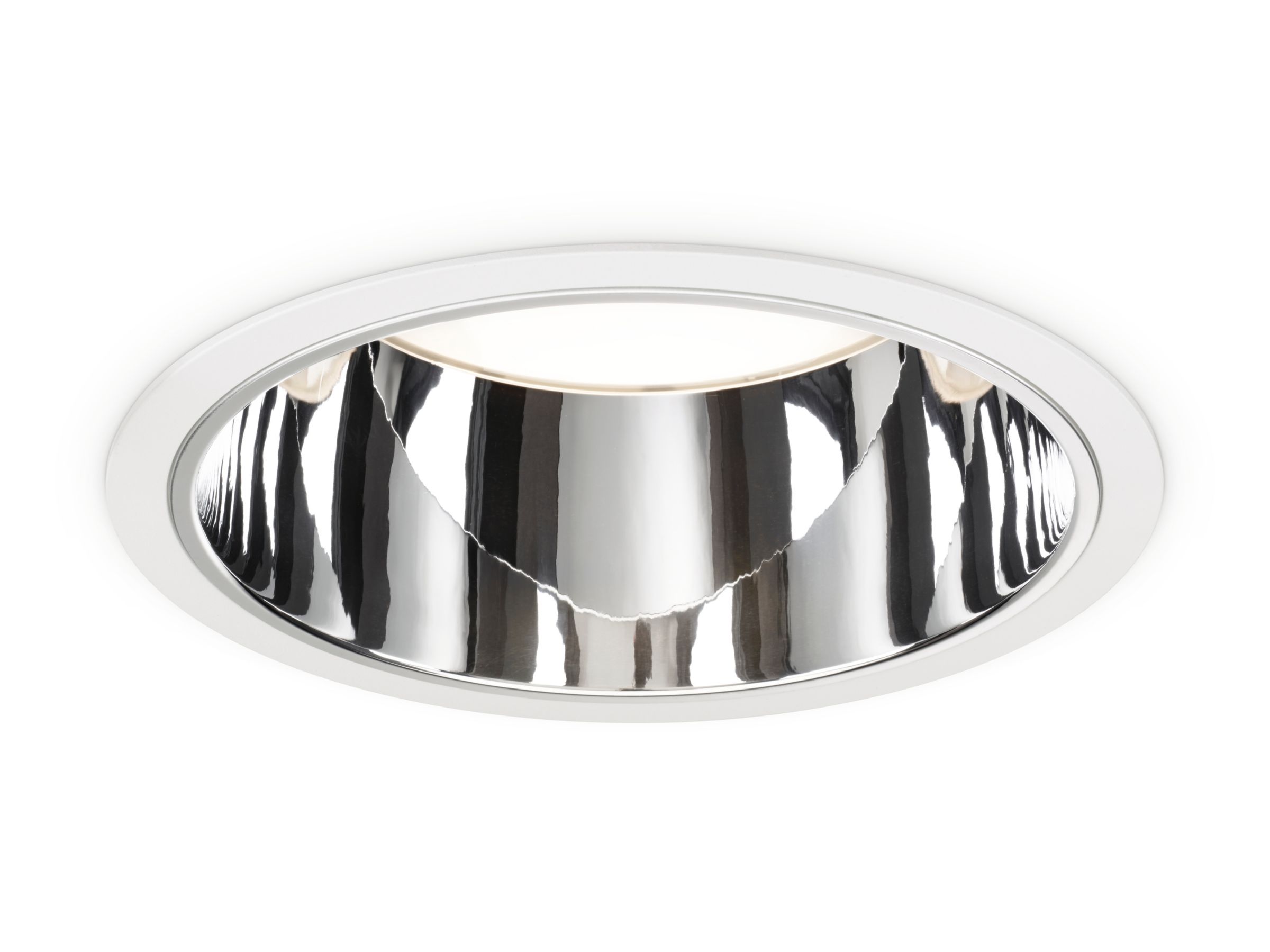

There are a few POE devices available other than IP cameras that link in with home automation:
Tablet computers:
Lights:
