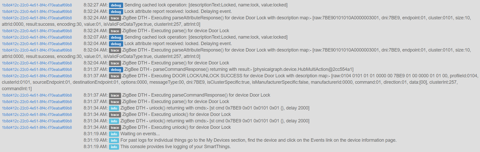

Now, if I unlock through the app it dutifully unlocks the door, however the status doesn’t change to unlocked and after a few seconds I get a message saying a network or server error occurred try again later. The door does indeed unlock though.
I’ve put the live logging mode on and this is what is occurring when I give a command to unlock
I’ve done a factory reset on the Yale and repaired with Smartthings a couple times now and still getting the same result.
Any advice, based on the logs, whats occurring? Faulty lock, faulty Zigbee module?

Hmm your IDE logs are showing that you executed unlock but your lock then returned a lock state.
One thing to check before moving to the app, open the IDE -> My Devices -> Click on your lock and do you see the lock attribute state show a locked or unlocked? If you can post everything you see on that page so I can look at the details about your module.

Trying a lock from the app, when it was already showing locked, I hear the door ping but not lock and the app gives a network/server error try again later. And here’s the logs

Where did you found that DH? I am just looking at the code of the official Zigbee Lock DH and the debug log’s comments should start like this: ZigBee DTH - .
Never mind, it is too late for me, and I just cannot recognise what is written on your images…
