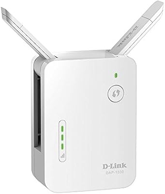

I don’t know if this will help in your particular case, but an old field engineer trick is to borrow a Wi-Fi access point That also has an ethernet port for a couple of days from someone else, plug it in close to your lock, and then plug the hub into that for the lock pairing.
I’m not saying there isn’t a design flaw, it’s one that people have been talking about since SmartThings first came on the market. Just wanted to mention the access point option as a way to move forward if you do get stuck.
This is a typical one, but there are many different brands and models. Some are called “range extenders“. Just make sure that the one you get/borrow has an ethernet port on the side.
