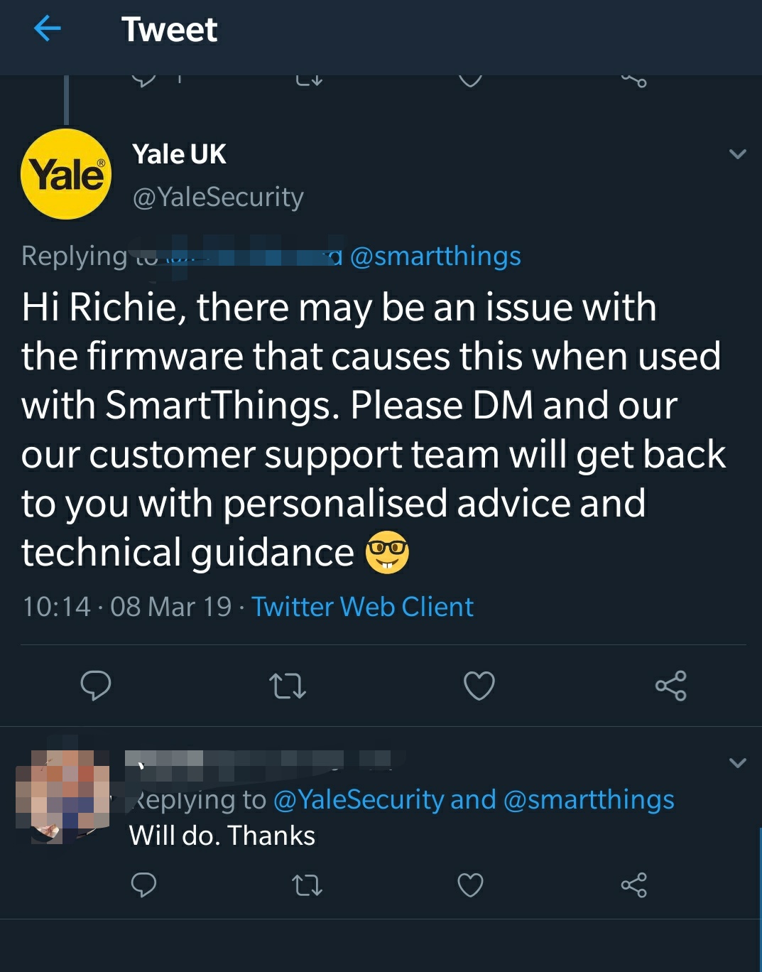

Same. I sent @yalesecurity a tweet today 07/03/2019 asking for an update. Such an important feature being left unresolved is unacceptable. If I had known I would never have made the purchase from Yale.

They’ve asked me to DM them so have.
And here is @YaleSecurity response… “not got any new firmware available”
