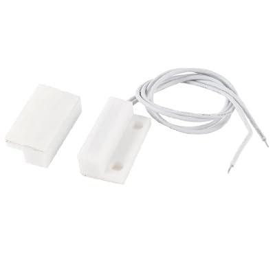

Get a Z-Wave sensor with wire terminals (e.g. Ecolink) and connect an extra magnetic switch to it for the other half.
monoprice also has door window sensors that can accept external contacts.

zwave contact sensors are in the $25 to $30 range, standalone magnetic contact switches are like 5 bucks.
Then there’s the batteries and fuggly factor to consider, two sensors = two batteries, and twice the fuggliness…

Oh…I was not thinking the external contact would connect to an actual cheapo alarm sensor. Sometimes I need a visual :smile:
So one of these and a monoprice zwave that has an external connector is what I need.

Thats the thing, one sensor does not work. You would have one sensor (zwave) for the bottom half then a wire coming out of it with a cheap basic alarm sensor on the other end protecting the top half. A trigger on either would trigger the zwave sensor.
Does that make sense?
