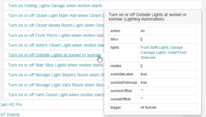

This just happen to me now. All my outside lights came on at 5:15. They are set for sunset. Here is what I show for sunset in my dashboard.
This is a snap shot of the last status of the bulbs.
That shows that they changed state 10 minutes ago. Around 30 min early
What does that mean? Is the Smarthings Scheduler in the cloud broke? Or is there something else?

I’m really not sure what’s going on with your Smart Lighting app, but I’ve had a Smart Lighting rule set up since day 1 of it’s release for turning on/off my outside lights at sunset/sunrise. Prior to Smart Lighting, I did the same thing within the Lights & Switches dashboard. I rely on this every single day (going on 2 years now), and only once it did not work. Do you have anything odd happening with multiple rules, or modes, or zwave/zigbee mesh issues?
There are many ways for this to be the case… my personal favorite (as it has bit me several times) is multiple smartapps that do slightly different things to the same devices. The automations made sense individually but as they triggered in real time turned into a complete mess. Some of these were from my own smartapps… live and learn… Forgetting that zwave/ZigBee devices do have a limited range seams to be pretty common on the threads as well as not wanting to do proper wiring(neurtral).
As the scheduler has been flaky for a while there are ways around this. I have found sunrise/sunset +1 or +2 mins is more reliable than simply sunrise/sunset. IDK why Rules Machine seams more reliable than Smartlighting, but it has been my experience and is an option. Also IFTTT can trigger sunrise/sunset events too. Finally if sunrise/sunset is very serious for you… use all 3. ie IFTTT for sunrise/sunset, Smartlighting for sunrise/sunset +2 and Rules machine for sunrise/sunset +4. There are lots of ways to skin a cat, sometimes you need to use all of them… wisely :wink:

I added an offset of 2 min and it worked two days in a row. Prior to that it failed 8 days in a row.
I was out of town for 3 weeks and did not work on the issue. Changing the offset started causing the lights not to turn off at sunrise. I started playing with an different offsets for both. It finally started working reliably everyday.
