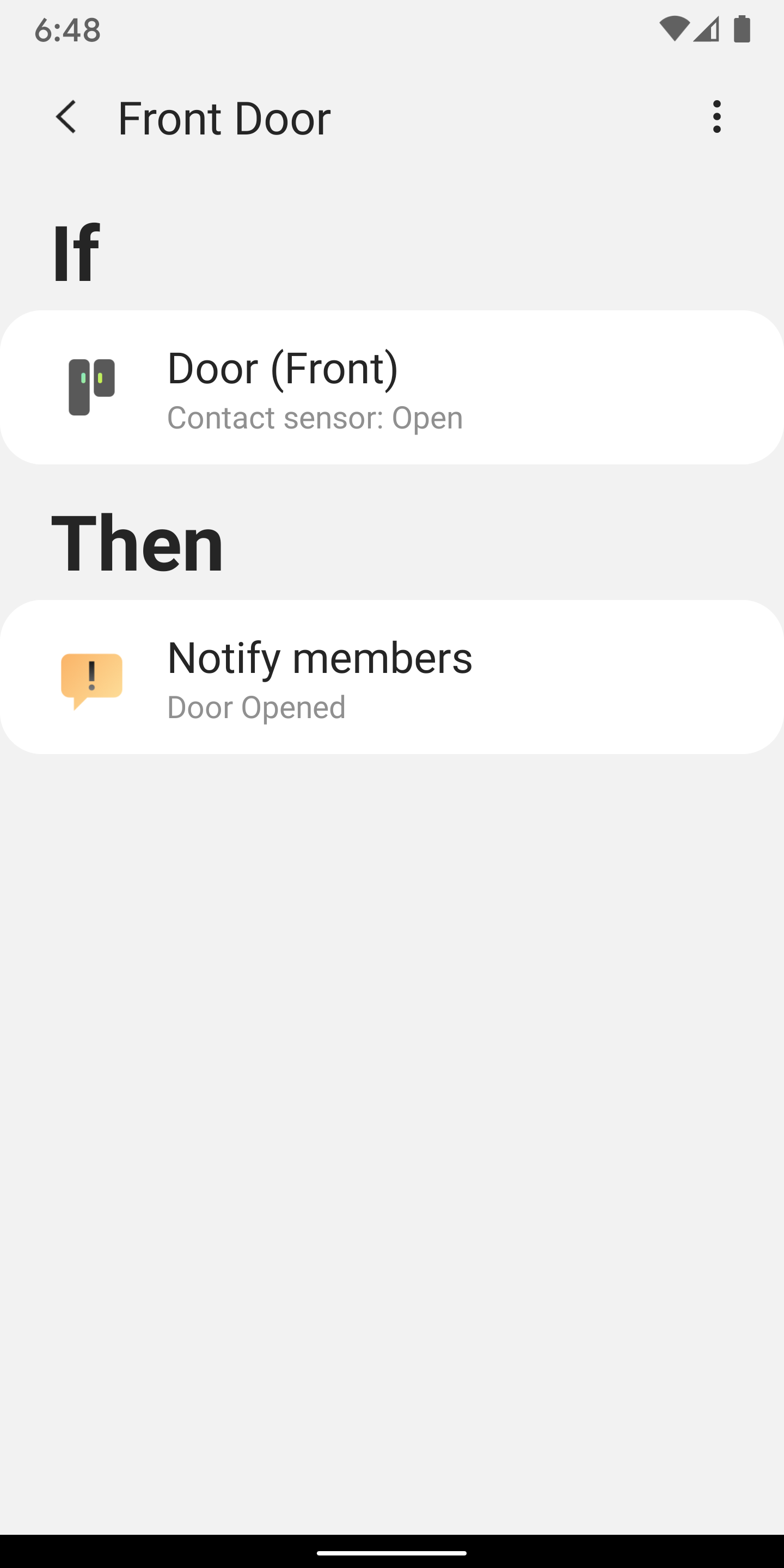

I set up a simple custom automation in SmartThings (see 1st picture below)

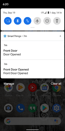

Now when I open the door I always get two notifications (see 2nd picture below). The first one is from my automation. But who’s sending the second one?
If you still have Notify Me When installed and running in the Classic app, then that could account for the second message. I can’t tell from the image you posted. If you click on each message, it should open the associated app so you can find out if the Classic app is responsible for one of them.

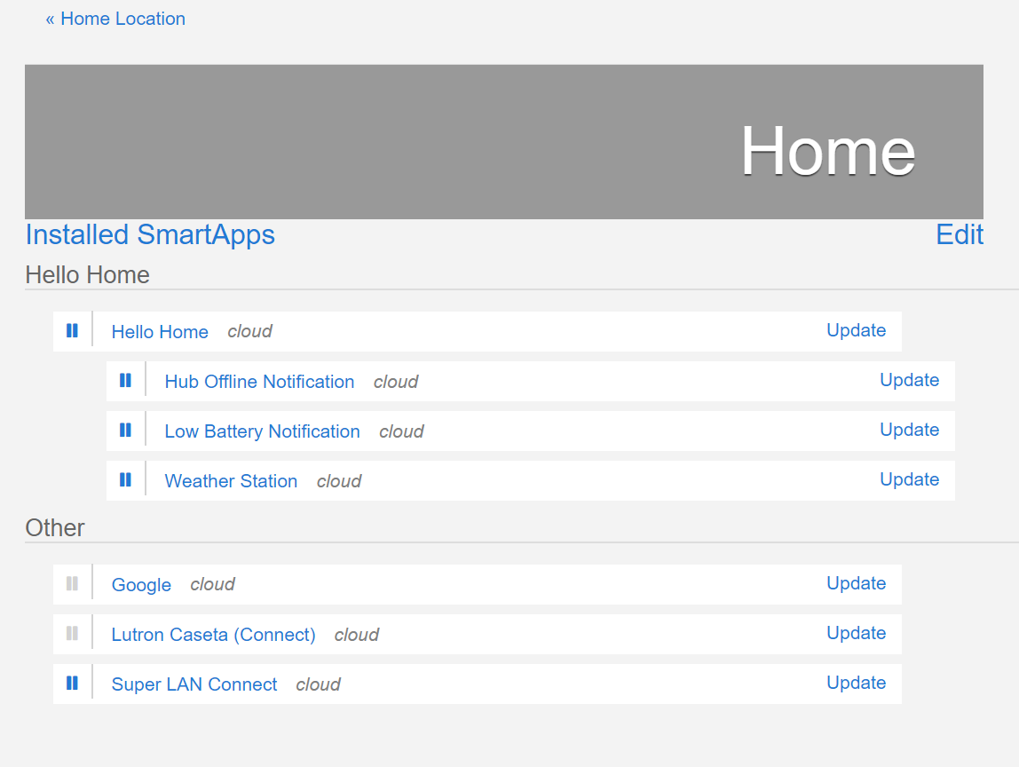

Nope. I reinstalled the Classic app and no smartapps were left behind (besides Google Home and Lutron Caseta services).

After installing the new app I started playing with the “SmartThings Home Monitor” SmartApp. Half-way through the setup process I decided it was too complicated and I didn’t want/need it so I tried to cancel my way out of it. This is where I got a bunch of delays, timeouts and errors. I was eventually able to delete the SmartApp from the Android app. Then I noticed from the IDE that it was still running so I deleted it there too, but I guess the push notifications never got unregistered.
