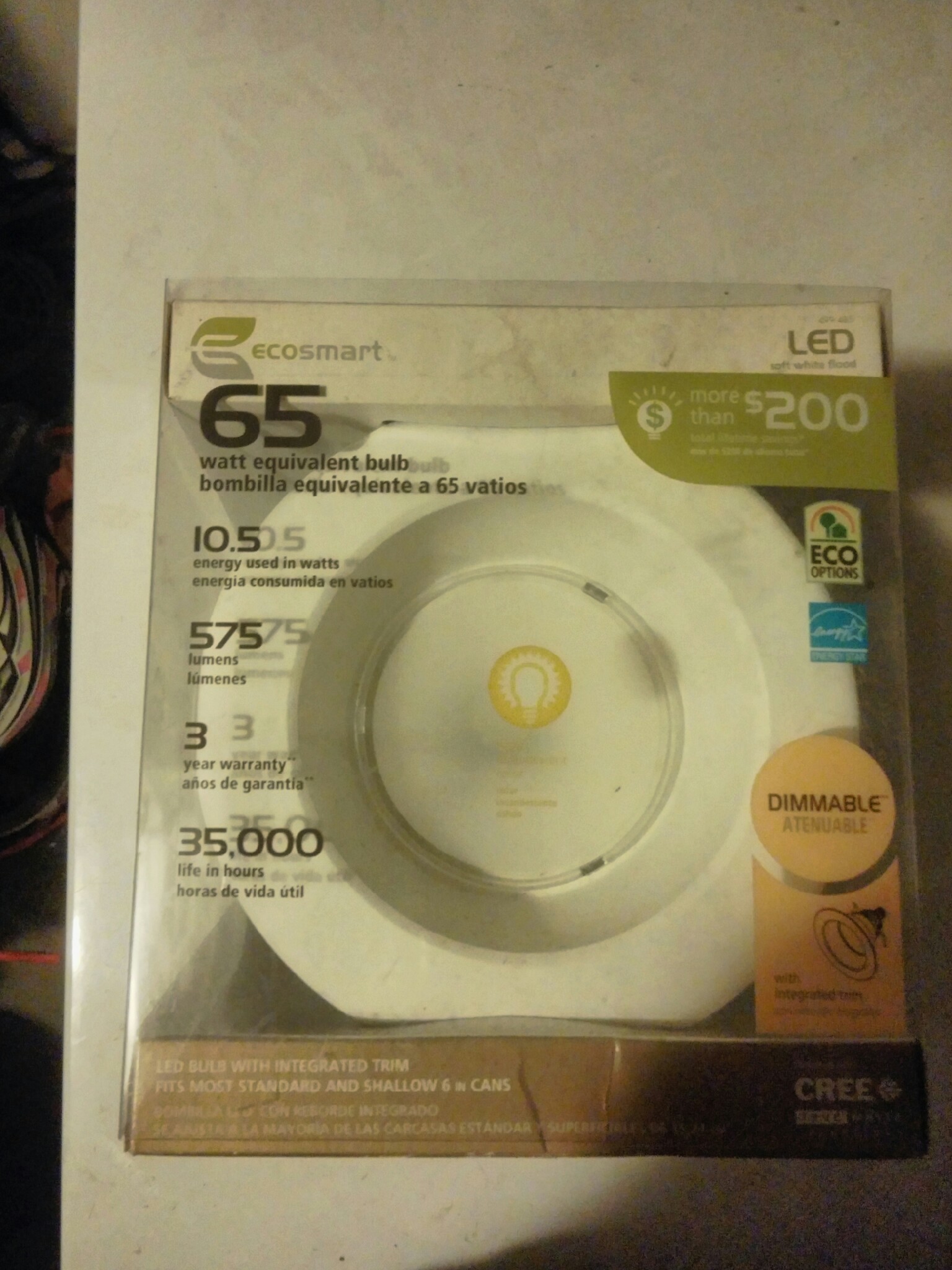

I have the Cree Ecosmart 10.5 W LED can bulbs ( From HD ) in all our recessed lights and never had a problem with flicker or humming. That said I use Leviton dimmers not GE
Thanks for your replies, guys. I left the Ecosmart bulbs yesterday to see how they fared and for being a Home Depot brand compared to a “known” brand, I was impressed. Today I’ll be going to big orange and try new ones, while I return the Philips bulbs.

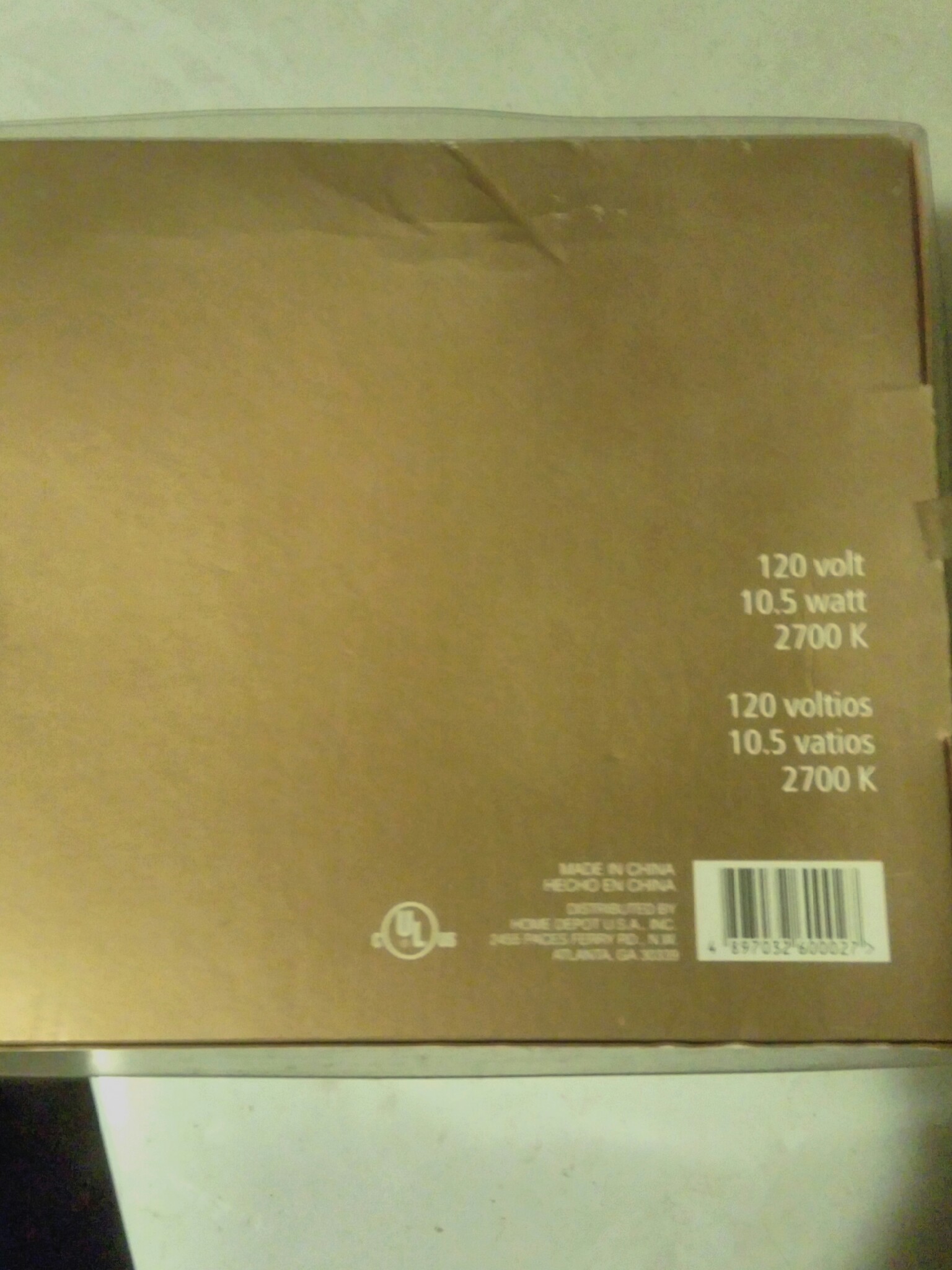

I just scanned the UPC on the Cree dimmable can bulbs I have and it came up with a flock of Pink Flamingo lawn ornaments. So I will just assume that these are no longer available.
The ones I have are 10.5W dimmable with the trim attached to the bulbs and work perfectly inside 6" cans.

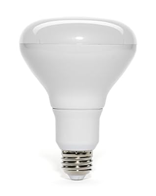

Thank for this. I am hoping to find the magical light bulb with a regular A19 or BR30 style. If none are able to improve the experience I’ll try replacing the whole can for these.
They dim very low and provide bright 1210 lumen at 100%. Customer service is great, too. I sent G7 an email after one of my bulbs did not work anymore after 3 months and they just sent me a new one.

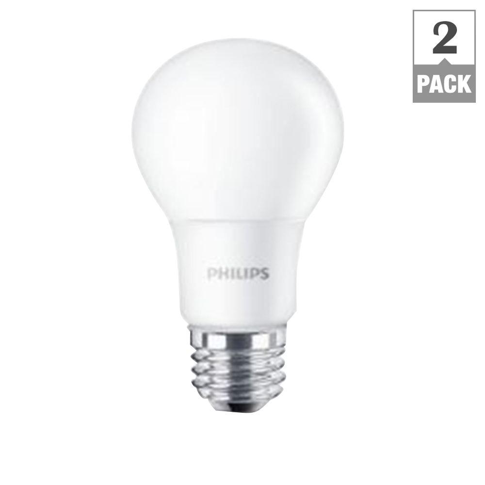

While mostly off topic, I was surprised to find that these Philips bulbs emit a buzzing noise when just used with a normal non-dimming switch:
Not really too relevant to the thread, just surprised Philips who are generally a higher quality manufacturer would make a bulb that buzzes in this day and age…
Not so off topic, Benji. I got the Philips bulbs I was using with the GE dimmers because they were “the best” out there. They do work with my Lutron Caseta dimmers, but not so well with the GE. At least in the small wattage that I use.
