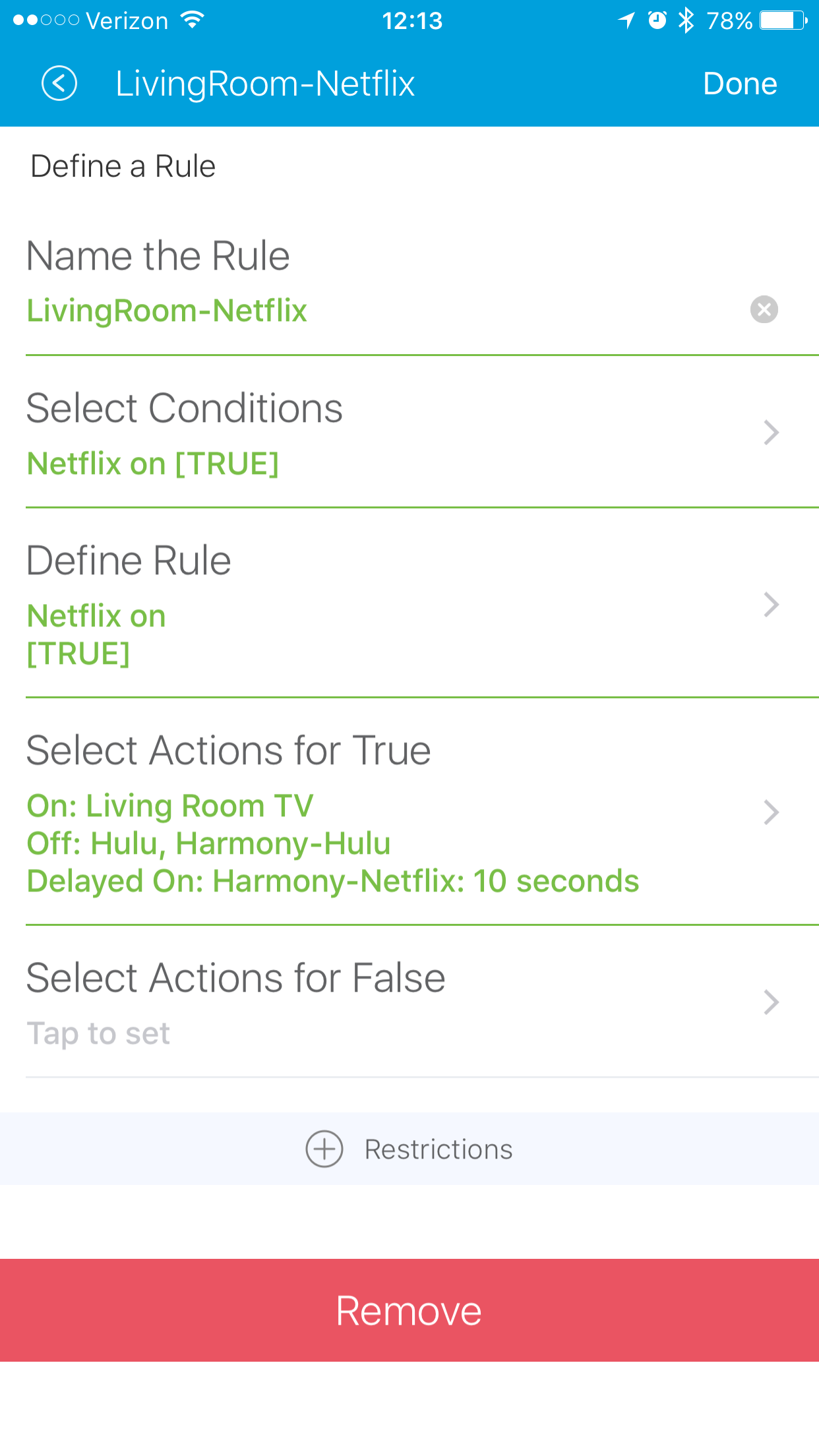

Using rule machine and a couple virtual switches. I say Alexa turn on Netflix. Tv turns on app menu pops up Netflix is selected and then my profile selected. I say Alexa turn on Hulu. Netflix turns off menu pops up Hulu is selected.

Three virtual switches
  1. Living Room TV
  2. Hulu
  3. Netflix
Two Routines in Harmony
  1. To turn on TV and set it to Netflix (basic commands)
    Turn on TV
    Wait 5 seconds
    Pull up Smart TV menu
    Arrow over to Netflix
    Press Enter on netflix
    Wait 9 seconds for Netflix to fully load
    press enter to select my Profile
  2. Harmony Routine Hulu
    Same as netflix but for well Hulu
3 rules
  1. Turns everything Off
  2. Launches Hulu
  3. Launches Netflix
Ah so basically just Harmony routines with ST doing some of the delay work, nice, thank you!
