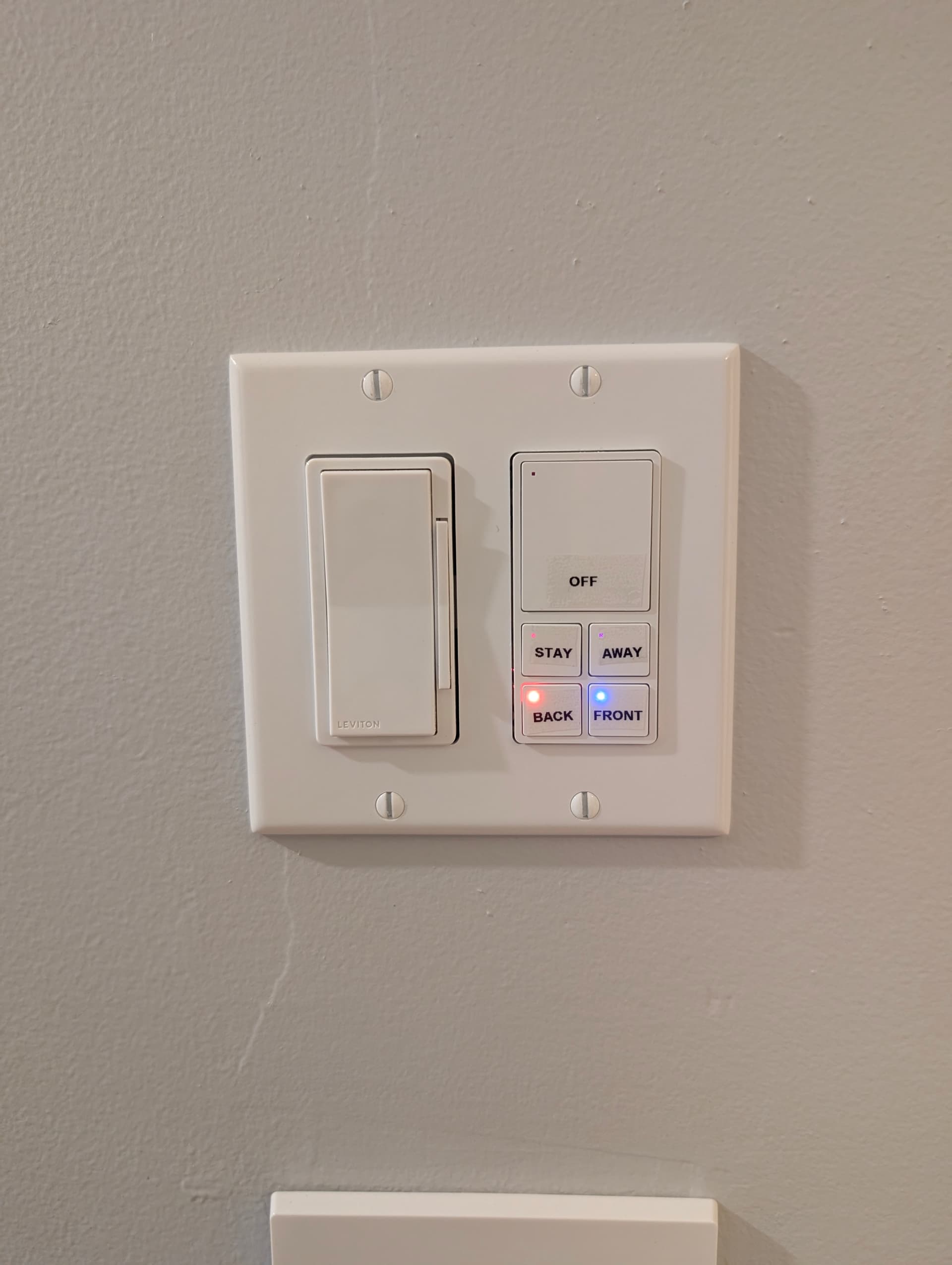

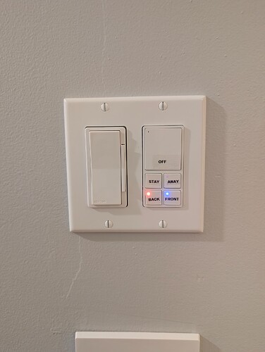

I got the Zooz Zen32 Scene Controller and it is a perfect solution for what I was looking for.
My setup:
Main button: turn off Home monitor
Button 1: sets Home Monitor to Stay
Button 2: sets Home Monitor to Away after a 30 second delay
Then no matter how my HM is turned set to off/stay/away all 3 of those buttons will show Off/Blue/Red. The LED response is very fast if I change the status from my phone or another routine. About 1 second.
Then the bottom 2 buttons show the status of my front and back door locks (red unlocked, blue locked)
So at a glance anyone can always see if the alarm if armed and the doors are locked.
