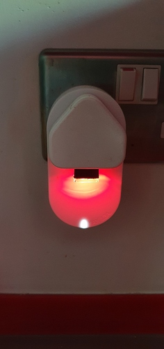

I have ordered these items image
I have a cupboard under my stairs that has power points in it, and some panelling around the doors. I am going to try using a smart plug, and a USB adapter, then drill a hole in the panelling to insert the light. Then stick a button above. You press the button and the automation will turn on the “armed” virtual switch which will in turn switch on the smart plug and the light will come on. Wish me luck :slight_smile:

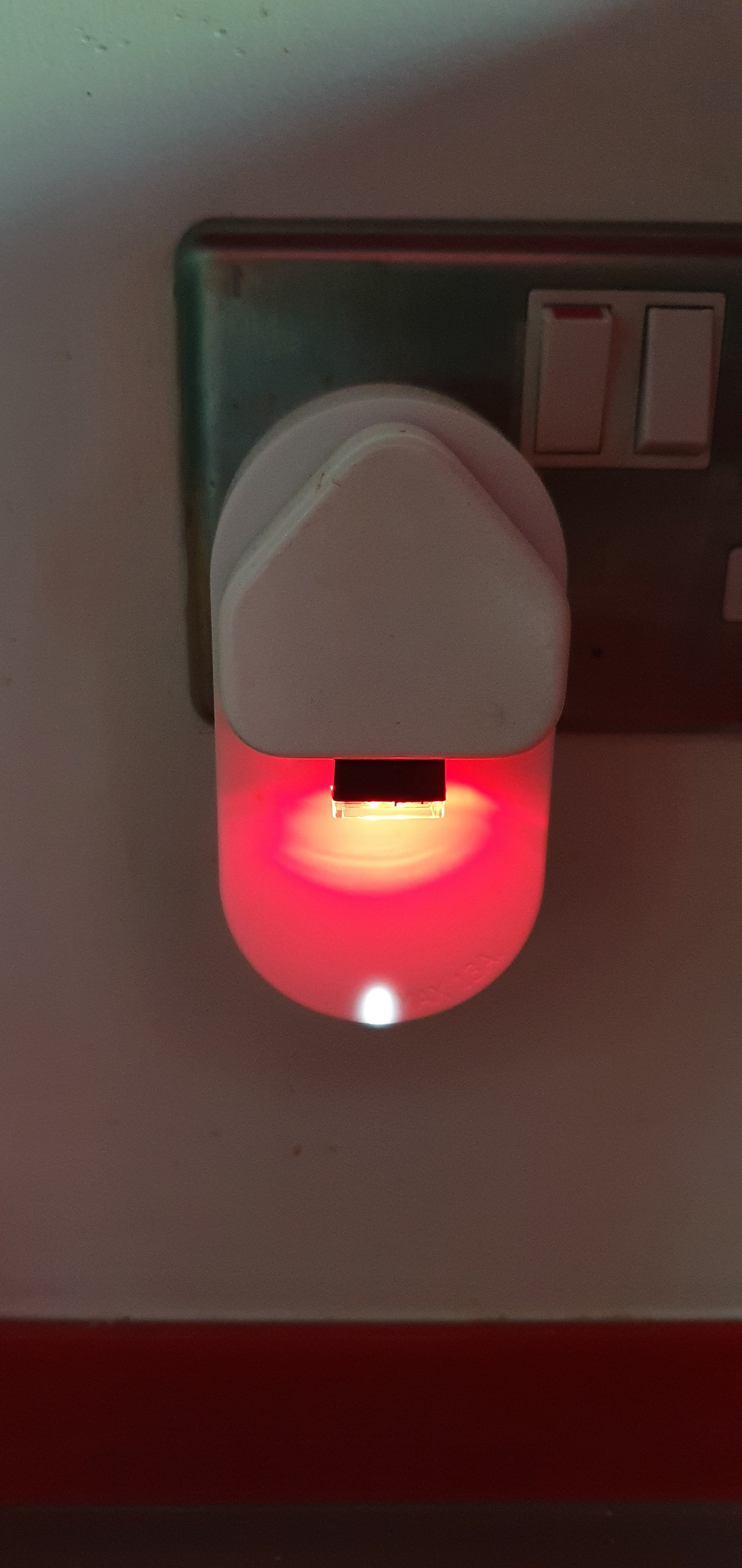

This is my crude implementation :slight_smile:

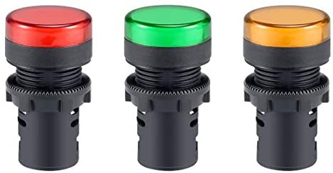

I use these mounted in a plastic enclosure, traffic light style. I also have some smartlighting rules set up to control them. All 3 are powered by seperate smartplugs and dc adaptors (yes, could save a few quid by using a single adaptor and relays, but I had them spare).
Red - fully set
Orange - setting or entering (alarm delay)
Green - disarmed.
So the lights don’t stay on unnecessarily (it’s mounted in the entrance hallway), I have a motion Sensor down there anyway, so the lights only illuminate if there’s someone there (and switch off again after zero motion).
Works perfectly and I use it in conjunction with a cheap rfid keypad (with a Fibaro ubs) to set or unset the alarm.
The idea was to have the wife/mother-in-law-friendliness of a dumb alarm system without the need to fanny on with tablets, phones etc to set, unset or view the current status.
I actually replaced the amber one with another from ebay which also beep-beep-beeps instead to give the audible entey/Exiting warning. Perfect.
So this is what I have actually done, for now. One of these, image that just fits snugly into a 10mm hole I drilled in the surround of my understairs cupboard and one of these image to cover the hole and diffuse the light so you can see it from the side too. USB adapter connected to ST smart plug inside the cupboard which fortunately already had a power point. So smart plug comes on when the alarm system is armed. Oh, and a ST button under it to arm and disarm.
