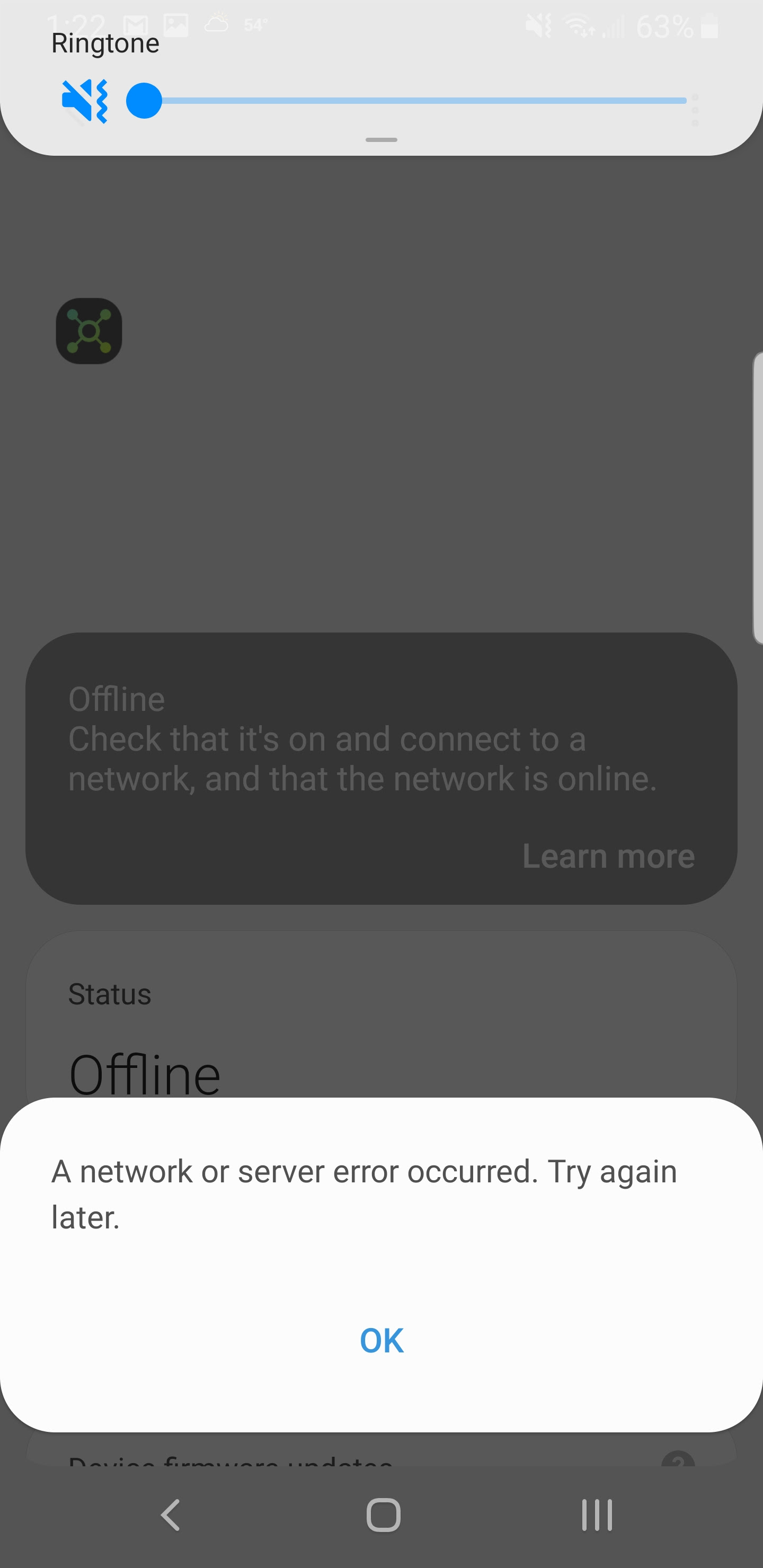

Now that I’ve got the new app working, I see a virtual hub, too. I absolutely used the simulater back in 2016. Just to be clear, I can just delete the virtual hub? Mine shows “offline” and I get “A network or server error occurred” when I try to look at it.
Yes, deleting the virtual hub should be fine.
I can’t seem to delete it from within the new app. I get an error just trying to view it. If I try to delete it, I get “Something went wrong. We are unable to remove your device. Please try again later.” I don’t see it anywhere in the IDE (so that I can delete it from there).
The virtual hub record deleted from the IDE but not from everywhere. I cleaned that up and you should be good.

My virtual hub says it’s offline and I can do nothing with it. And I only have one location. How do I get rid of it?
So this was counter-intuitive…
I tried to open the device itself and got nothing other than it spinning looking for connected devices. No menu options to delete or anything.
However, when I opened up the hamburger menu from the main page, then went to devices, there was the 3 dot menu in the upper right that gave me a delete option. I selected that, scrolled down to find the virtual hub and deleted it. Problem solved.
