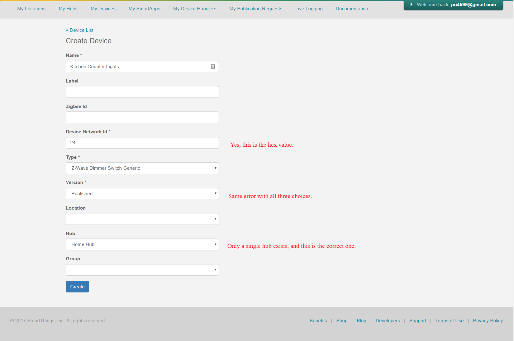

Share a screenshot of your values before saving
Yup. I assume the Reference ID means something to someone.
1
Remove the Hub value
Already tried that: “A Device must have either a Location or a Hub”
Funny that it’s not starred as required when it is required.
Aha! Location works, with the possible value ‘home’. Hub fails.
Seems the device isn’t local, it’s in the cloud. Hmm…

I only populate location if I am creating a manual device.
Once you have them displaying in the app, it comes down to the network id being correct to actually give function to the device.
Agreed. 36 decimal directly from Vizia, 24 hex. Smartthings says the device is online, so it’s seeing something. I’ll post an update after the full repair.
