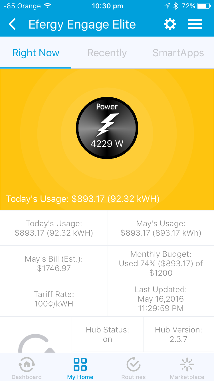

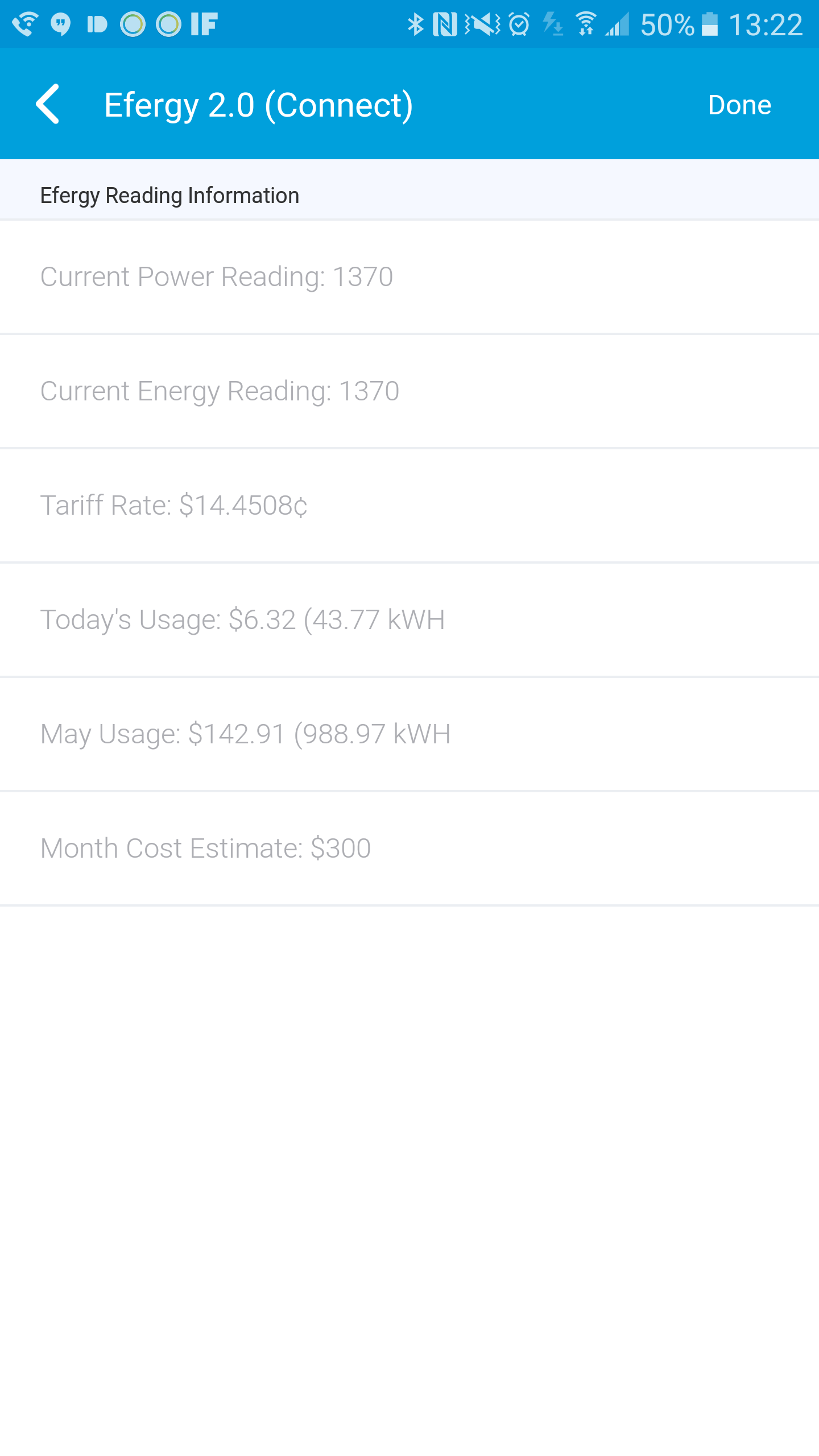

When you check your daily usage on the engage website what do you look at? im still trying to figure out why my daily figures aren’t matching up i wonder if i’m comparing the wrong figures. i switch to week view on history and hover over today
but the smartapp is showing

I have the same issue as Big_Webstas, my daily usage in Smartthings is more than double that of Efergy web interface, check these attachments
The data displayed in SmartThings is the data pulled from the api. I don’t make any calculations so the issue is not the app/device.

EDIT: Sorry, I thought this was for the incorrect $ (which shows the monthly $ for daily in your screenshots), not usage. Ignore below
Change line 174 of the Efergy device type to:
sendEvent(name: “todayUsage”, value: “${state.currencySym}${todayCost} (${todayUsage} kWH)”, display: false, displayed: false)
The current code has this listed as monthCost on this line.
