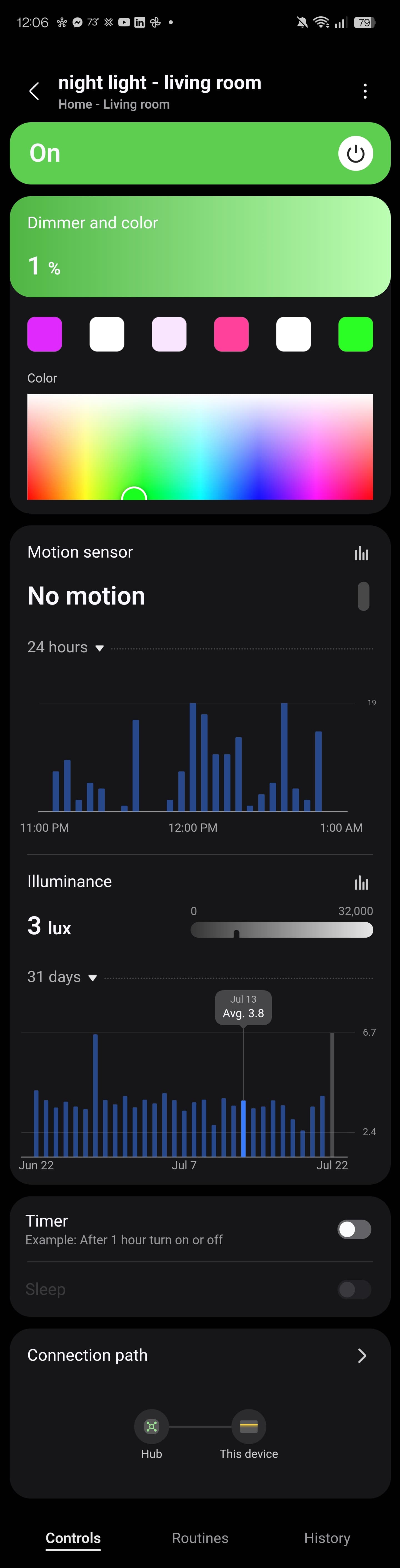

Old thread, but I just got this Zigbee ThirdReality multifunction night and it’s LUX feature isn’t that accurate.
I installed the SmartThings Edge driver and the ThirdReality Zigbee multifunction night light is working except for a certain condition of LUX. When the LUX is showing a level of 3 in SmartThings, and a darken the room so it should change the LUX level to 1 because I cannot see anything anymore, this device does not change the LUX at all. It will change the LUX level to 1 when the LUX level is above 7 and I darken the room. So obviously trying to use the LUX sensor in SmartThings is a dealbreaker since either their firmware sensitivity threshold or SmartThings driver do not report LUX/Lumen changes accurately enough for my environment.

this is the driver i’m using:
and this is how it appears:
Thank you! That worked for me!
Didn’t realize it was labeled as a switch. I appreciate your help.
