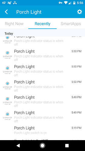

Constant LED status reporting - Is this necessary? Is it clogging up communication in the ZWave network? See screenshot:

It’s a known issue, but it’s not flooding your zwave mesh, just the event log. I highly recommend emailing support, and when you do please reference my support ticket #287314.

I have exactly the same issue. I’ll submit a case and reference #287314 also. Every one of my GE zwave switches is filling my event log with the same led message.
Same here. Random on different switches, but chronic.
