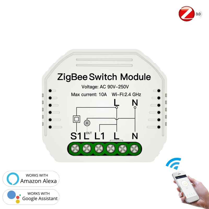

Will this do? € 6,05 52%OFF | Tuya ZigBee 3.0 Wifi Switch Module With Smart Light Switch Module Smart Life/Tuya Remote Control Work With Alexa Google Home
Thanks, looks really promising with EU shipping, gonna try it, any custom DTH needed?
No i used the zigbee generic switch witch is an 9fficial one

Your post mentions both zigbee and Wi-Fi. These are two different protocols. Some manufacturers will make two models, each with the identical case, but with different firmware inside. So you need to know what you want, or if you are OK with either one as long as it works with SmartThings. :sunglasses:
If you use a Zigbee Device, you must also have a smartthings hub. If you use a Wi-Fi device, you might not need anything except the switch.
Note that many Chinese sellers, particularly those that sell on Alibaba, will list a device as both zigbee and Wi-Fi when it is not. They are just trying to come up higher in the search results. So you have to read the product descriptions very carefully.
Also note that there is a common translation error where a device will be labeled Zigbee but also have a separate label for “Wi-Fi 2.4 GHz”.
It’s not a Wi-Fi device, it’s that both Wi-Fi and zigbee use the same radio frequency, although the messages are different. ( like two letters that use identical envelopes, but the messages inside are in different languages.)
Anyway, some Chinese factories will stamp “Wi-Fi 2.4 GHz“ on the English language version of devices that use a 2.4 GHz radio for a different protocol, not understanding the difference.
This is often a giveaway that the device is either a counterfeit or does not have standard safety certifications, since it would not have passed the certifications with that error. So that’s another thing to look for. :thinking:
