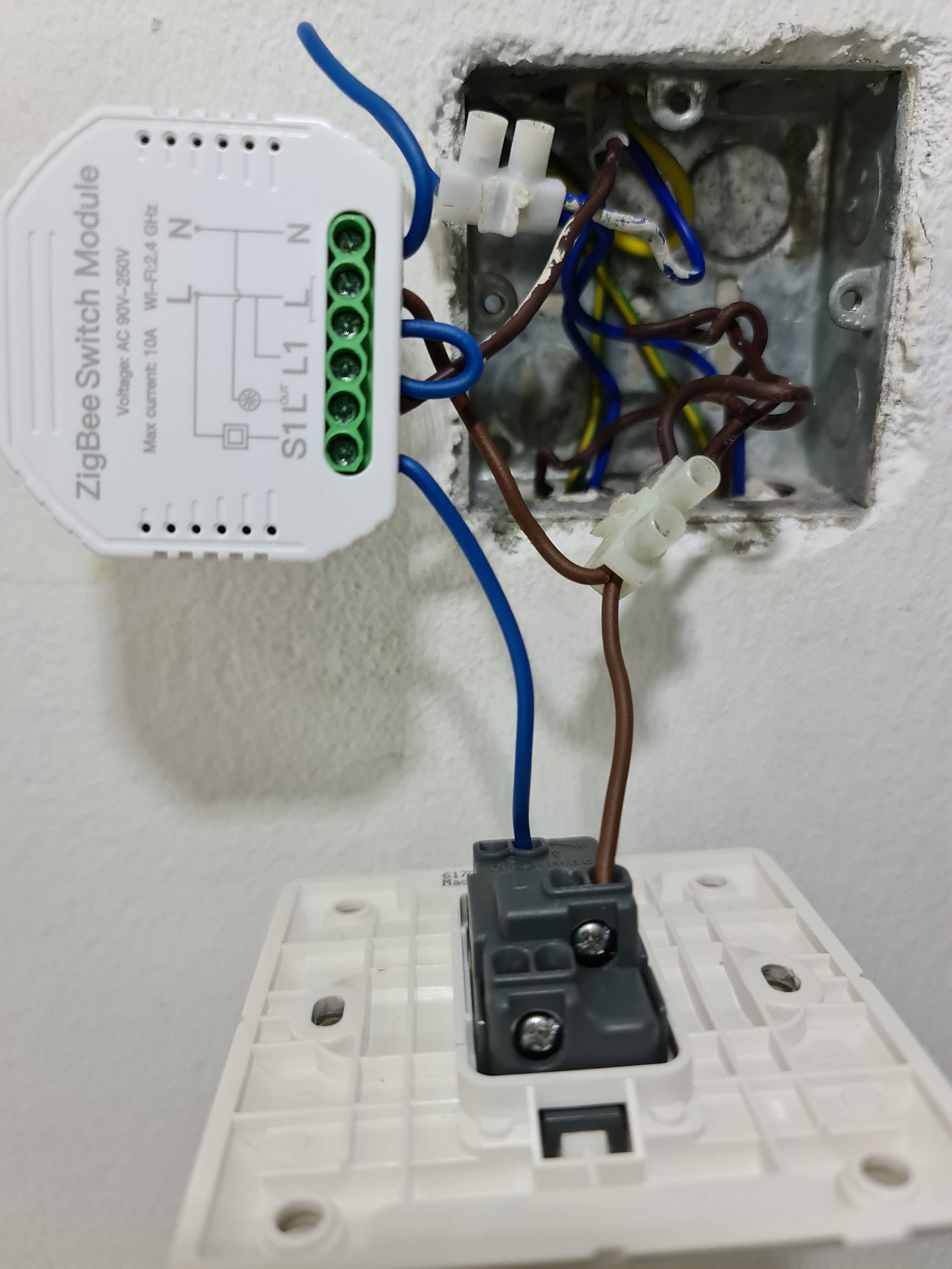

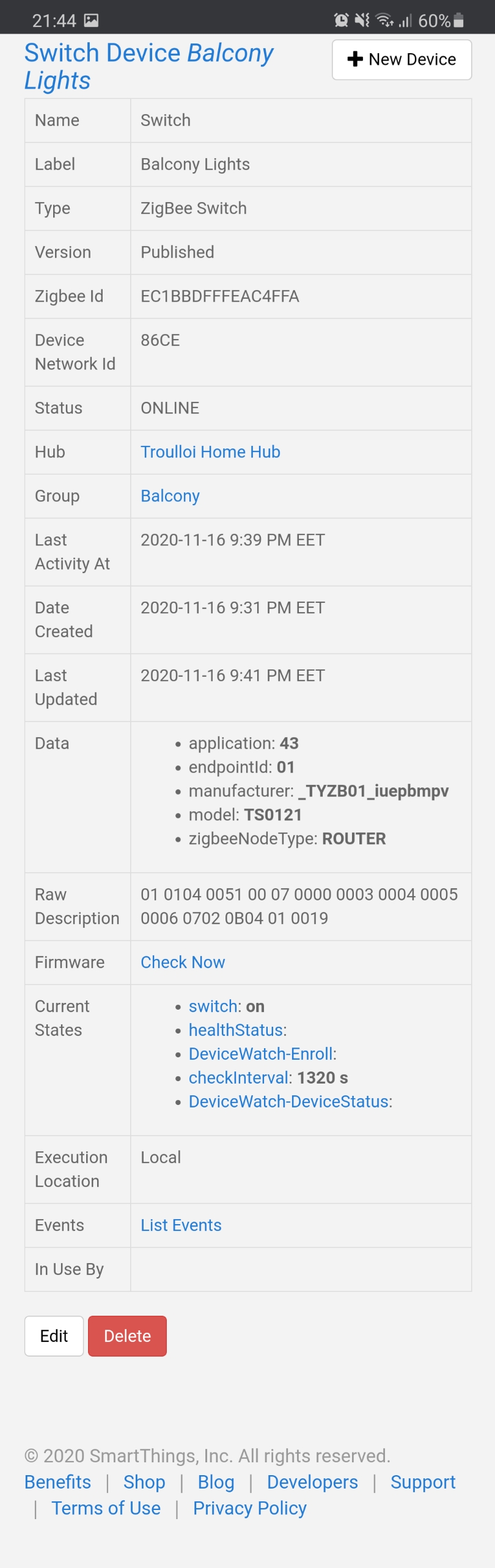

I have bought a Tuya Zigbee 3.0 switch a few months ago from China and it finally arrived today. Being inpatient as i am, of course i had to install it tonight. On the device it self, it states both zigbee and wifi for some reason and it has no button for pairing. I can verify that the device is indeed zigbee and bellow you can find both a link to buy and a couple of pictures from the whole process.
One thing to note is that this is not metering switch but it does run locally using the zigbee switch native dht from Samsung.
€ 6,05 52%OFF | Tuya ZigBee 3.0 Wifi Switch Module With Smart Light Switch Module Smart Life/Tuya Remote Control Work With Alexa Google Home
Feel free to ask me anything.

According to the comments in the Aliexpress link, you have to turn it on and off 5 times until you hear an alarm like sound, and that’s when it goes to pairing mode.
I previously had cases like this that to pair/unpair a zigbee device with no apparent switches/lights, its just a on/off exercise of 4 or 5 times (that’s why I keep a lab on/off switch with L-N-G cables handy to do this :stuck_out_tongue: )
Yeap you are absolutely right. Did that. Surprised the heck out of me tbh.
Thank you for this.

I have one of these with smartthings and another with tuya in another installation of house family. They work fine.
I was paired about the defect with the dth zigbee switch power and It matched with the fingerprint. 0051, it is power meter id and 0B04 the cluster.
It sends me consumption 0.0w, because I have it without connecting the relay. I only use the change of state to detect power failures.
test with the DTH zigbee switch power
