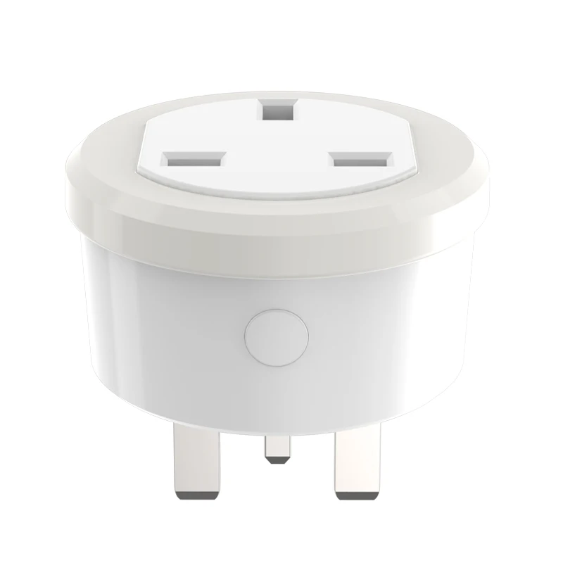

That was how the Amazon one I picked up appeared it showed on the app and added totally fine but it just said it couldn’t connect any time I told it to turn on/off
Amazon what Ben ?? what did you buy, was it an Ikea plug ??
it was one of these
simple task of changing the device type Ben, should be good to go after that, have you accessed the IDE before ?? if not this should help

You are quite right I haven’t access the IDE bofre and again with it coming up as “thing”.
St app found the device just didnt seem to be able to control it at all. And not being familer with the IDE stuff I didn’t wanna mess anything up. I’ll follow your steps when I’m home from work and see if I can get it working. Thanks

Ok so I’ve managed to follow your directions Mike, low and behold damn thing works straight away. :partying_face::partying_face: Just having difficulty getting Google home to recognize it so I can use the voice control functions now… :face_with_raised_eyebrow:
