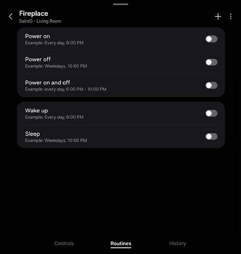

The Viper devices also have options to “Wake up” and “Sleep” that the Edge_Child do not have,
