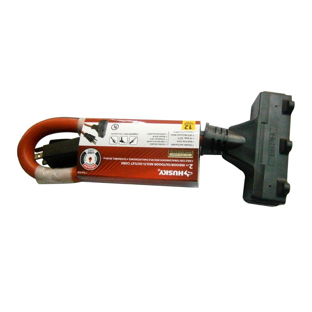

you can buy something like this…

So this:
Plus two of the zwave outdoor plug ins.
