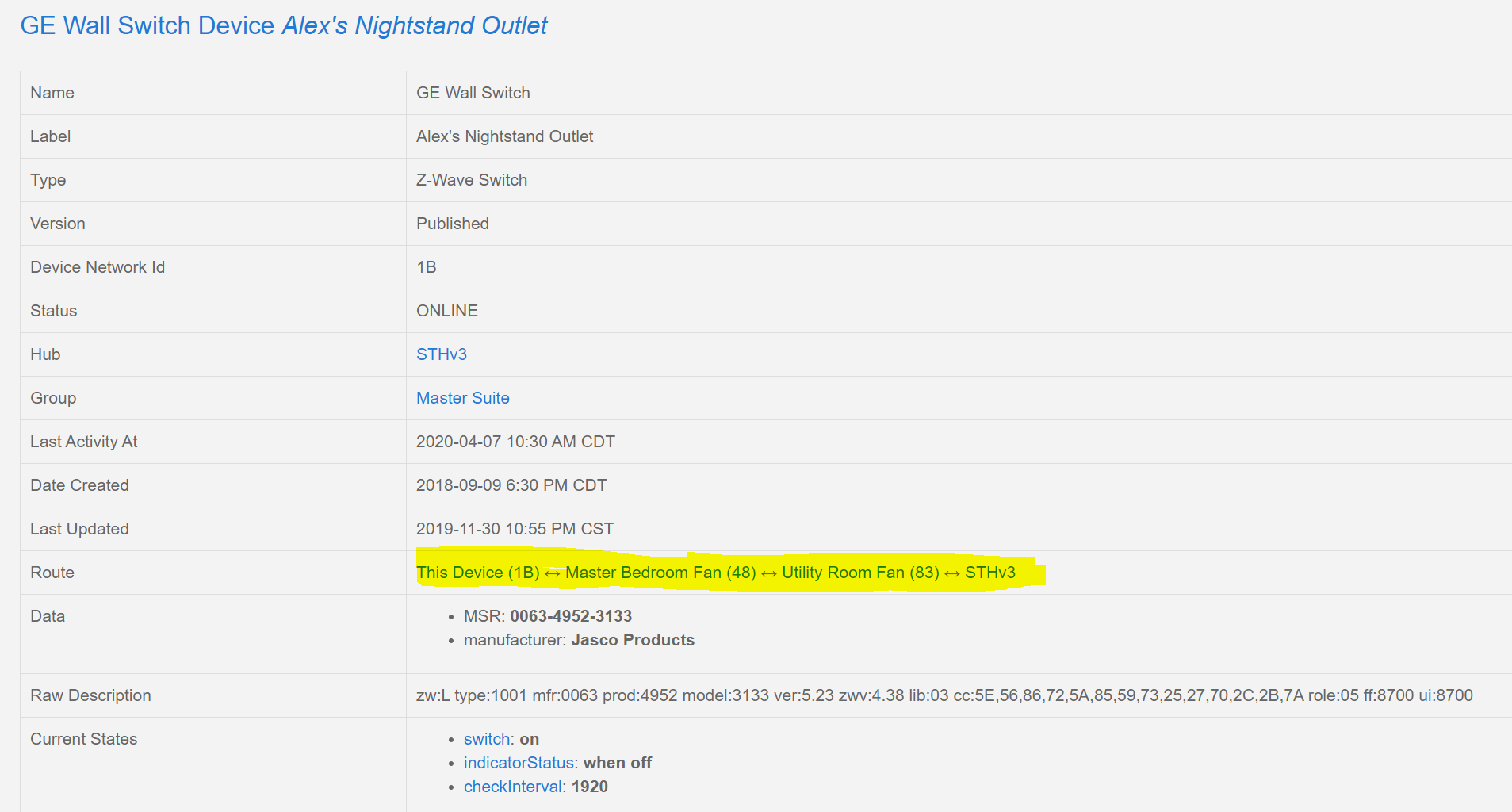

Either way, if one is stable and the other isn’t, I would suspect one of two things… either it is defective, or it is connecting to a different intermediate node which for some reason is causing issues. The absolutely cool thing is that the ST IDE now shows the route to the hub!! Check if both outlets are taking the same route to the hub… I have seen devices next to each other take crazy, and different, detours to the hub.
