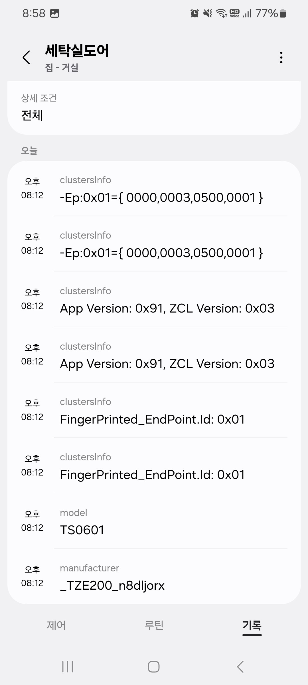

I want to add 1 door edge drivers, is it possible??
Please give me the edge drivers in the picture.
_Kim
(김성광 Kim)
January 24, 2025, 12:30pm
39
I’d like to ask for one more.
