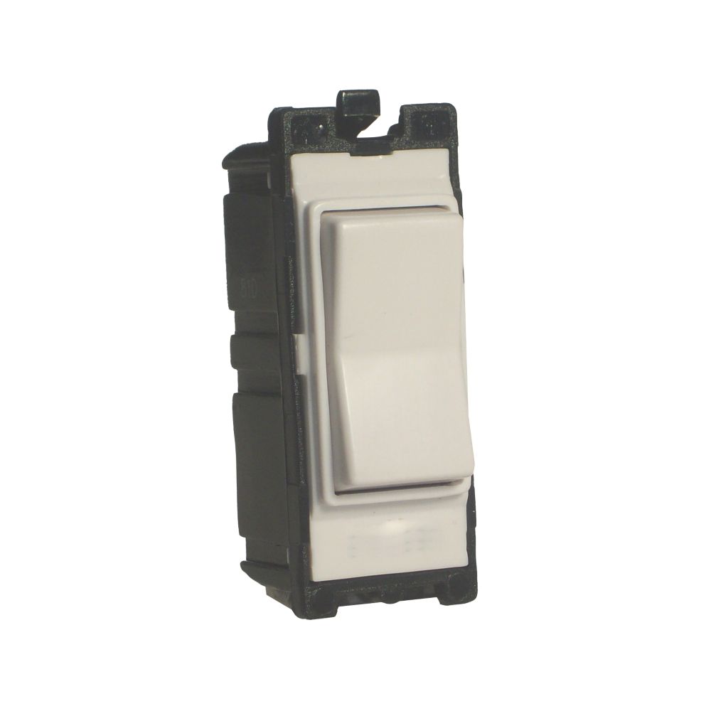

Thanks for all the comments. I wanted to give some feedback on what I have gone for, its modular but will feedback on functionailty.
its a 2 way retroactive rocker switch, which I thuink should allow up for ON, down for OFF, hold up for DIM-UP and hold down for DIM-DOWN. In practice I will much prefer this to a push button switch, and also allows for Dual switches.
I will feedback how I get on but for those interested from Screwfix @ ÂŁ6.20:
27120 x 1 Varilight White 10A 2-Way & Off Retractive Switch ÂŁ2.75
85638 x 1 Varilight Z3PGRID1 1-Gang PowerGrid Gridplate ÂŁ0.93
46446 x 1 Varilight XDQPG1 1-Gang PowerGrid Faceplate White ÂŁ2.52

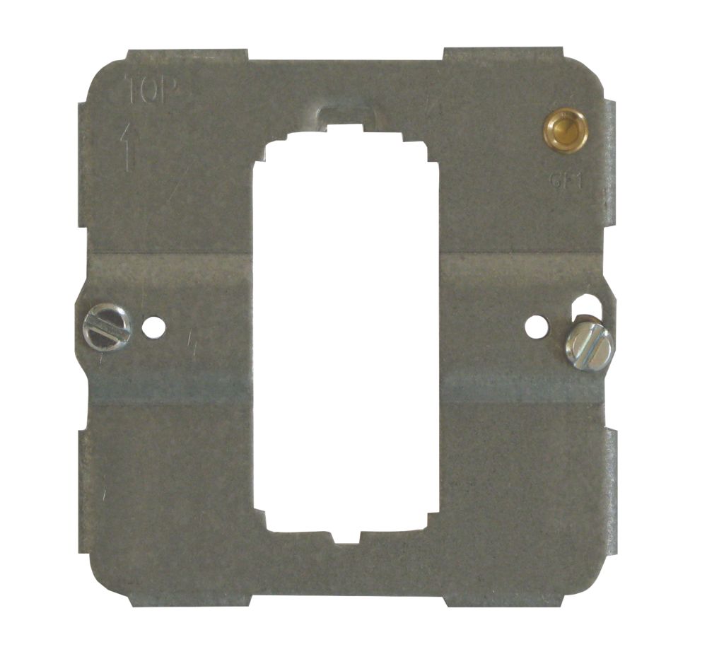

Got the switch and tried installing. Had some issues with the DH I was using meaning only the down button worked on the switch, but have since also found the style of backplate does not allow enough room for the dimmer2 to fit despite being a deep back box. I have therefore switched to a toggle switch using @hajar DH and its working perfectly after amending parameter 20. Back to the drawing board for the rocker switch!
