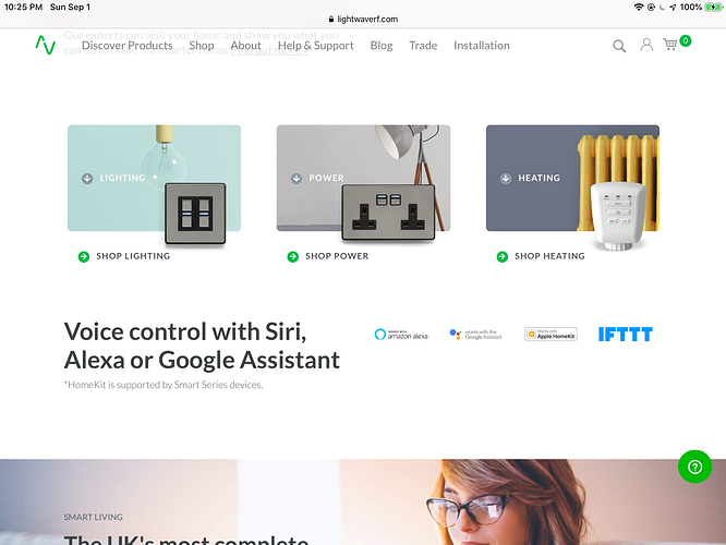

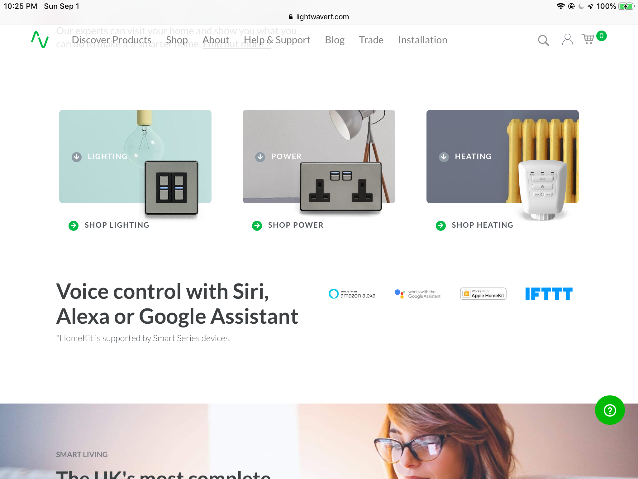

One brand which comes up under this option which you might want to consider is lightwaveRF. You do have to get their hub as well as the smartthings hub, but it’s a very nice system for the UK and one of the only ones which has sockets as well as switches.
@borristhecat gave you excellent advice on the back boxes and all that, and all of that would still apply, but this would give you another range to consider, particularly as it includes sockets. :sunglasses:
Their heating line does not yet have a SmartThings integration, but the Gen2 switches and sockets do.
https://lightwaverf.com/

Thanks @JDRoberts it was late last night so didn’t have time to find some pictures :slight_smile: . Although im not as keen on the light wave stuff, it looks good but it’s not a mesh so this limits you quiet quickly in a house, but it is another option.

I’ll go lightwave rf for all the dimmers. They’re not super cheap and they’re expensive when you need 2 + gang dimmers but for all of my rooms I only need a single dimmer socket so they’ll be fine.
