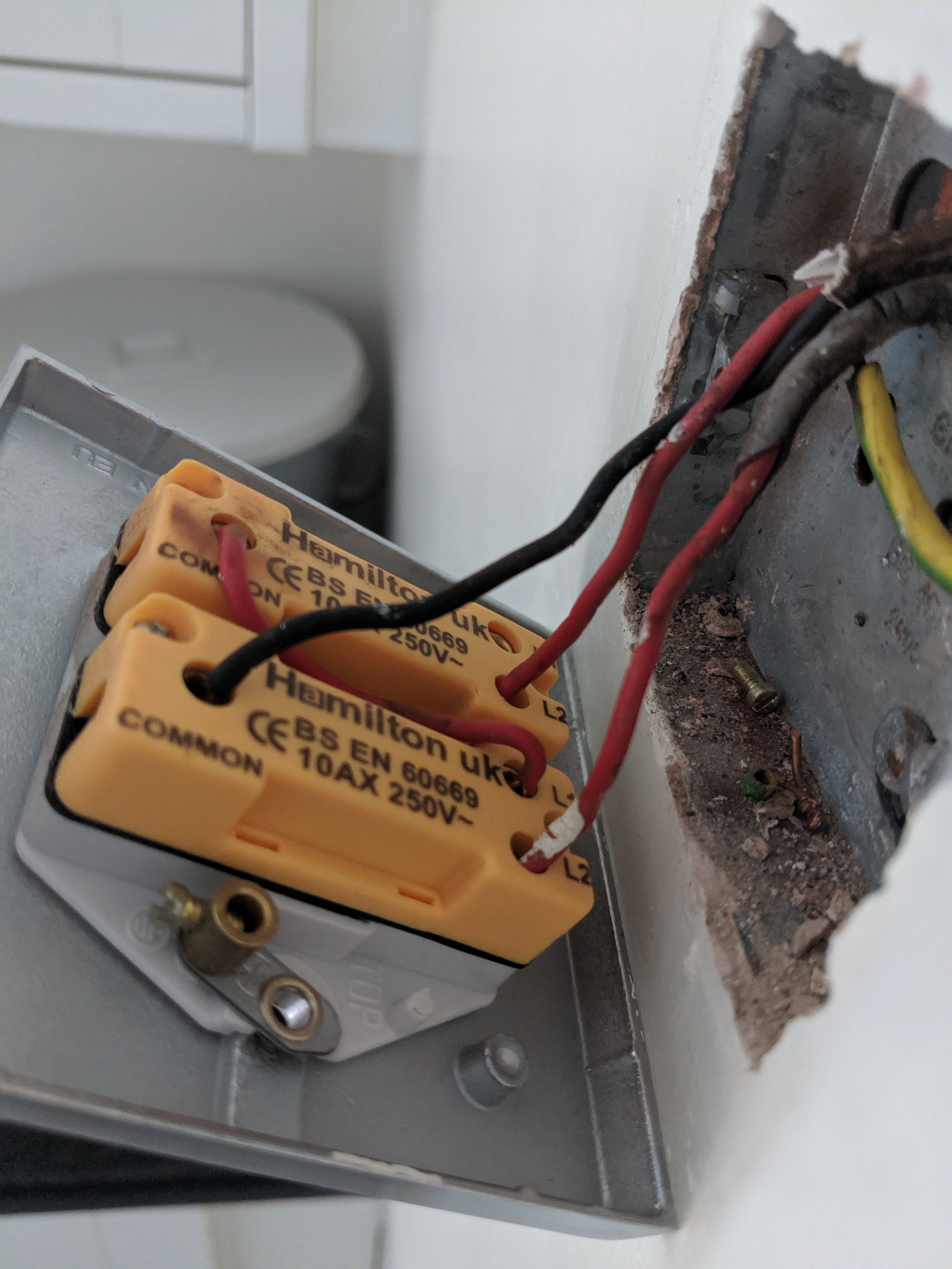

So I’ve got to installing the Fibaro dimmer and I’m faced with this… not sure where the second red (common?) wire should be included?
Looks a little odd. Which switch does what there?
