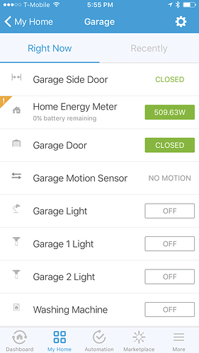

Can someone tell me how to eliminate the battery as I have it plugged in and it says “0” Battery and prefer it not show at all. I am using iOS. Thanks.
Here’s an updated version of mine without the battery tile:
With the new version of the app for Android and iOS, you shouldn’t need to change a thing, but just in case look at lines 83 and 104 in the code. It’s self explanatory on what to change.

Thank You John that does it. Is there a way to increase the size of the text for the 'min was" and Watts data was reset on"? on the iPhone the text is very small and almost impossible to see.
@joelw135
Take a look in the code at lines 84, 88, and 105, you’ll need to change the first two ‘standardTile’ to ‘valueTile’ without the quotes. Problems with how iOS renders text differently from Android.
Thanks, did it in the IDE works great. Would you please provide the Github settings so I can add it to the repository for future updates.
Hi @joelw135 and @Jimxenus, turns out v2.2.2 and v2.2.3 (Android) fixed the rendering issue, so I just updated my code in Github so it’s the same for both OS’s. Thanks!
