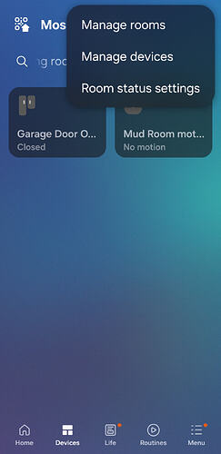

Don’t see that option on Android.
can you take a screenshot of what you see and post

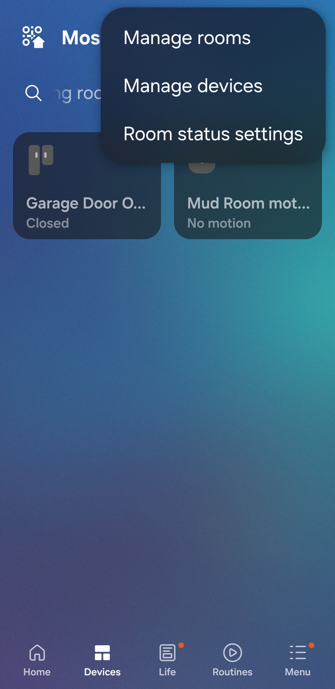

Difference between v2 and Station hubs in Android app.
v2
Station
Nor do I on this phone, but it should also be in the three dot menu on every Room on the Devices tab and I do see that

My screen, again maybe a v2 issue and the devices were installed within 14 months.
