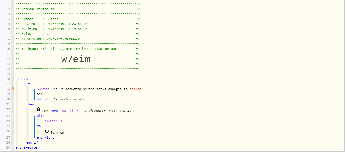

Now I have created a simple piston in webcore as below.
The problem is that, the status change of Switch3 to online does not trigger timely. It takes few minutes for the SmartThings app to know it went offline or online and hence delay in action. I have given refresh every minute in app settings. Anything else need to be done?
FYI. My idea is to turn off Switch3 in 5 mins if it turns On. So as to Turn Off I am using power allowance automation. To turn On am using above webcore. Any better idea is welcome.

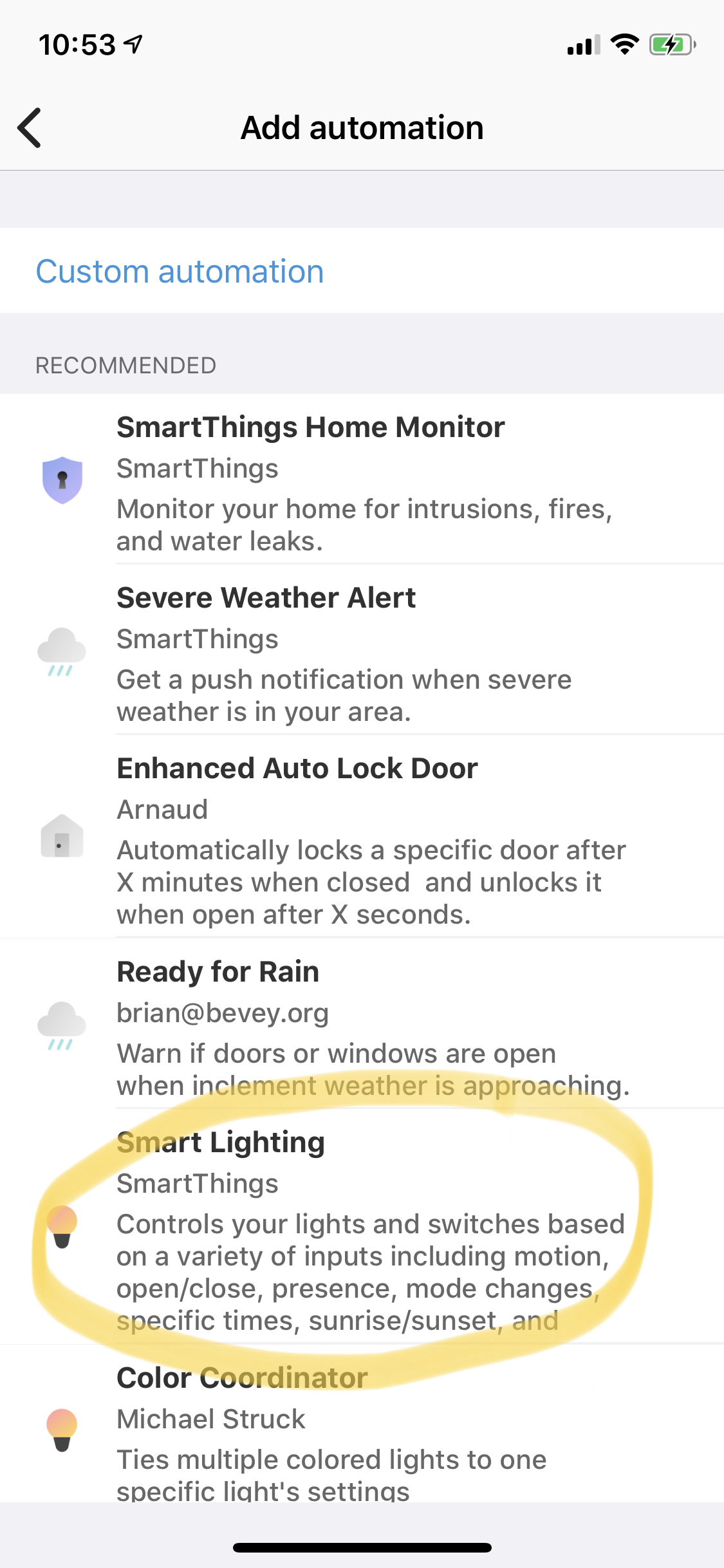

The easiest way would be to use the official TP-Link/SmartThings integration and use power alliance in the new app. Use Smart Lighting instead of custom automation.
In the new app I don’t see a screen like you shared. For me it’s as below. Please guide.
Hmm…not sure why you don’t have the list of recommended smart apps.
