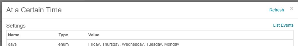

Not sure why the inconsistent behavior but keep in mind I don’t mean refresh the webpage… when you get to your smart apps and click “Update” to the right of the timed event… when you go back into the details it WILL read the same as it did before. In the top right corner of that window (next to the X) you will see “Refresh”. This is what I was referring to.
