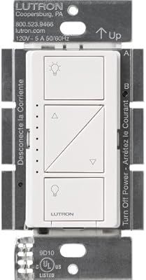

Lutron Caseta
@Automated_House thanks for your response - This one? Doesn’t this require the Lutron “Smart Bridge”?
Yes it does to integrate with ST
Right, looking for a zwave type dimmer that can integrate into ST .
That doesn’t require a neutral wire? I have never seen one. I have a situation without a neutral, that’s why I went with the Caseta.
All z-wave dimmers I’ve seen Require a neutral. There is an in wall relay that doesn’t. Otherwise Lutron is the only way.
