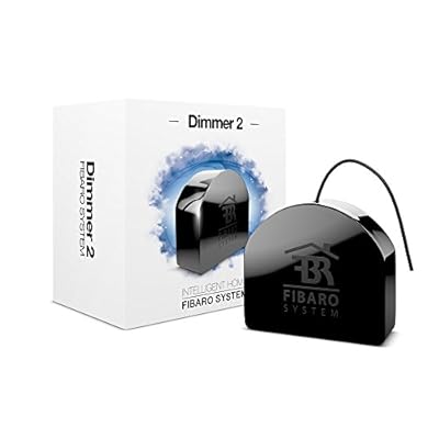

As far as the in wall micros, many people use those by putting them at the light fixture rather than in the switchbox. There’s almost always a neutral at the fixture. This will work in both the US and the UK. There are several brands available.
There is also one model, the Fibaro dimmer 212, which is a micro that can be installed without a neutral.
They were probably refering to these. If placed at the light, you can use the neutral there when there is none at the switch.

If you mean a rotary dial analog dimmer switch it would burn out the micro dimmer. The micro needs to control the amount of current draw for itself. So you want the wall switch just to send it a pulse message and then the micro will decide what to do with the current.
Read the user guide for any of the micro devices, they’ll tell you what kinds of switches are compatible.
