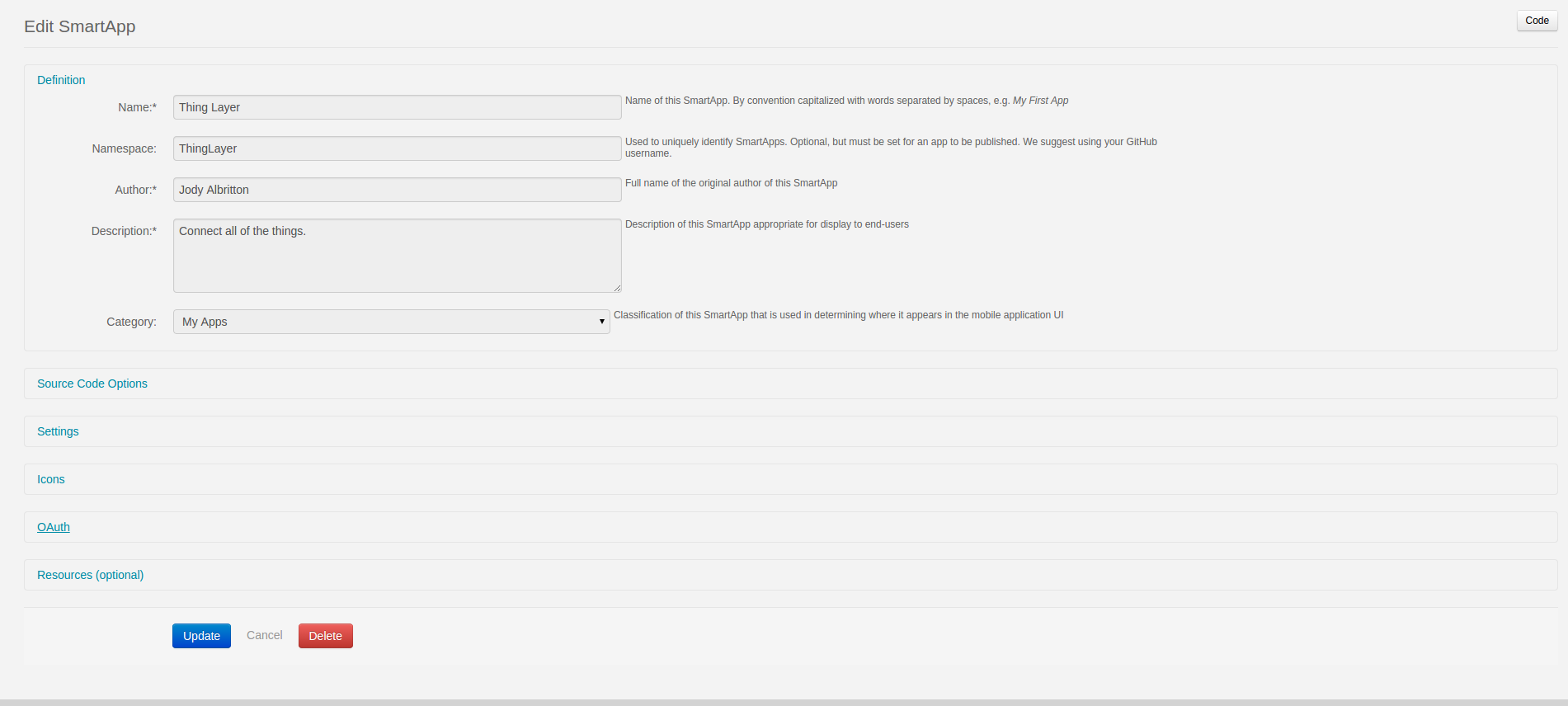

@baldeagle072 Did you enable oAuth in the SmartApp? You also need to apply your oAuth by creating a file config/application.yml
@baldeagle072 some things I have not tested:
I have not tried to have two “ThingLayer” apps installed at the same time. If you had been using my server before, this could be causing a conflict.
You might need to change the namespace and name of your ThingLayer SmartApp. The oAuth settings and name space can all be found under the edit app page.
I didn’t think of that. I will try that when I get home
Ok, I got it working. I thought I had enabled oauth, but apparently I didn’t press update. Now, I cant open the “Locations” tab. In the browser console, I’m getting the error: “GET http://IP:3000/assets/bootstrap.css.map 404 (Not Found)”

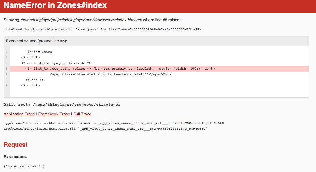

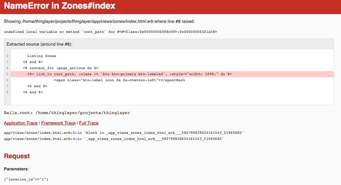

If I attempt to edit a location, I get this error:

@amaiman You may have found a bug. I will be pushing a fairly major update to the master branch this week. I will test for the behavior you are seeing on my code.
