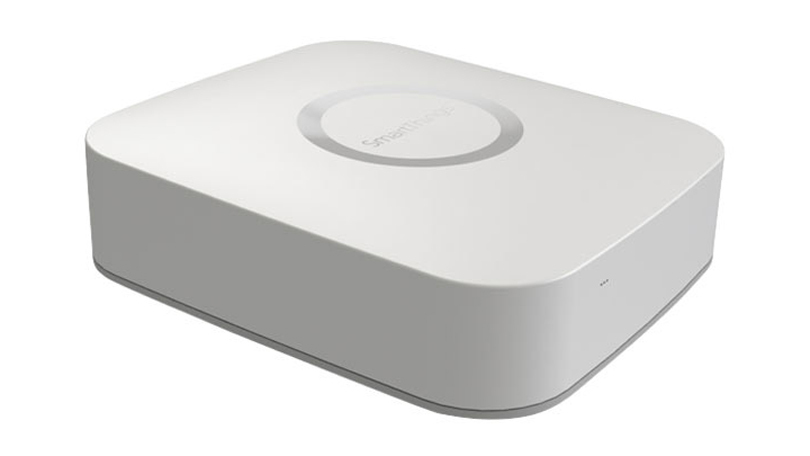

I have the V2…i think
the 2015 version
What’s the model number? It will Be on a label on the underside of the case (and also inside by the battery compartment for the V2).
