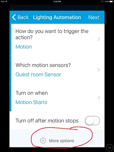

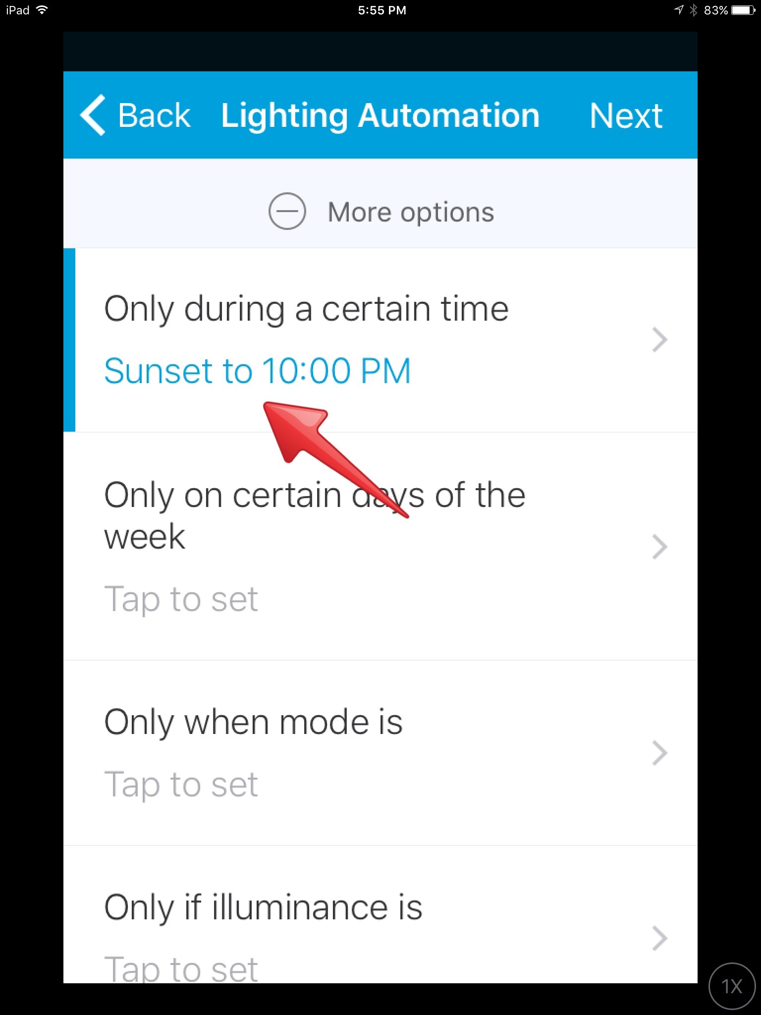

Thanks to some recent changes, you can now do this with the official smart lighting feature. You add the time constraint at the very end of the rule.
So first you pick the switch you want to come on.
Then you say you want to have it come on with motion and identify the motion sensor.
And then you use “more options” to restrict the automation to just run between sunset and 10 PM.
It works well, it’s just you’d never know it was there until someone pointed out to you. :sunglasses:

This used to be true, but it no longer is. Now you set the start time and the end times in two separate steps and you have more choices now. :sunglasses:
See the screenshots in my post above.

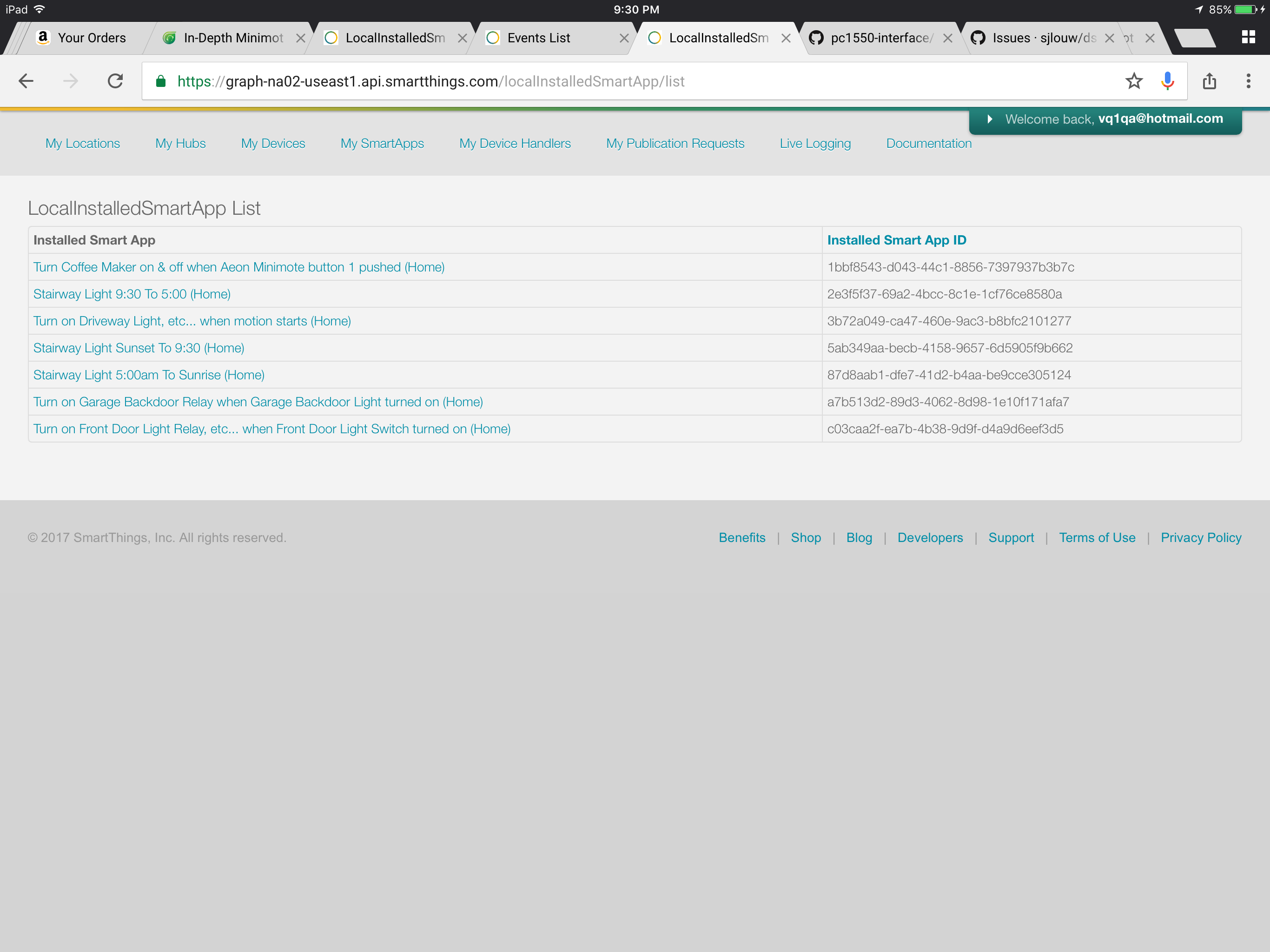

I have mine set up like that and it actually runs locally.
Unless something has changed, which is always possible, I’m pretty sure the “sunset” part the OP requested will not run locally. That requires checking with the cloud.
https://support.smartthings.com/hc/en-us/articles/209979766-Local-processing
Additionally, sunrise/sunset and mode changes cannot process locally. Using these as triggers for Smart Lights will prevent the automations from performing without an active internet connection. Use a different trigger, such as At a specific time, instead to ensure your automations can run locally.
Your not able to do sunset to sunrise but you can do sunset to time and time to sunrise .
Interesting! Have you tested it to see if it actually works when you’re disconnected from the Internet?
The sunset to 9:30 worked during yesterday"s outage. I will test it tomorrow with the cat5 disconnected.
Cool. It may work, but just not update the sunset time until you have the Cloud connection again.
Thanks for helping out JD. I wasn’t aware smart lighting had that added ability.
Just tried it with the cat5 disconnected form the hub and it worked.
