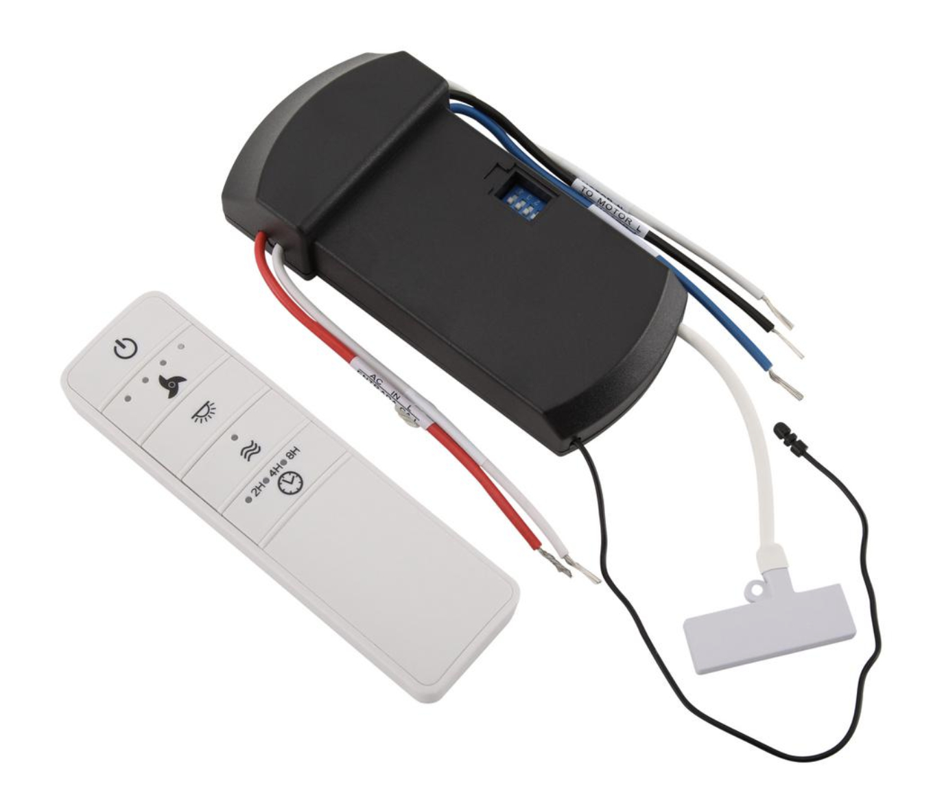

I’m sure you figured this out by now, but you probably should have read the manual. The controller isn’t four-speed. It has a “breeze” setting that is position four and it randomly changes the fan speed randomly. 1=low, 2=med, 3=high, 4=breeze NOT med.
This is not quite correct… The Hampton Bay Zigbee Fan Controller has 4 speeds (Low, Medium-Low, Medium, High) + the Breeze setting. I have the device and just cycled through all of the speed settings + Breeze. Whether or not the DTH you’re using supports all of the speeds in ST is another matter completely. I can adjust all 4 fan speeds + Breeze mode with the included RF remote as well as my Hubitat hub where it is currently paired.
i have two of them and it’s three speed and breeze. Does your remote have more than four green lights? I never paid attention to the four buttons in the app as i voice control everything. The remote definitely only has three speeds.
My remote has 4 speeds, as shown above in the photo on the left. I have tested it and verified that there are indeed four speeds. When Breeze is selected, the fan speed randomly cycles through the various speeds.
The remote control above in the photo on the right is for the Non-Zigbee Fan controller. Some users bought that unit just for the wall-mounted remote control, and use it with the Zigbee Fan Controller. That remote looks to only have three speeds.
You are wrong about that. Both remotes are just radio remotes. They control zigbee receiver pictures below
Both remotes can connect to the same receiver. One is hand held other is wall mounted. Both are battery powered devices
I don’t think so…
Yes, I agree that both remotes use the same RF communications to canopy modules. My point is that the handheld remote comes with the Zigbee fan controller only. The wall-mounted remote comes with the non-zigbee fan controller.
The Hampton Bay ZIGBEE Fan Controller comes only with the hand-held 4-button remote control shown above in the left hand photo.
Check out the Home Depot link below and you’ll see that this model comes with the Zigbee + RF Fan Controller Module.
https://www.homedepot.com/p/Hampton-Bay-Universal-Wink-Enabled-White-Ceiling-Fan-Premier-Remote-Control-99432/206591100
Whereas the wall mountable Remote control (right-hand picture above) is bundled with a NON-Zigbee Fan Controller module. It only does RF. Note the missing white antenna in the images for its canopy module.
https://www.homedepot.com/p/Hampton-Bay-Universal-Ceiling-Fan-Wireless-Wall-Switch-68109/205846346
You are right about that wall mounted comes with non zigbee controller that you can toss away. Switch both remotes to same rf channel that matches zigbee controller, and they both control same zigbee controller. How do I know? I have them. Search through forum, and you find post from about year ago
