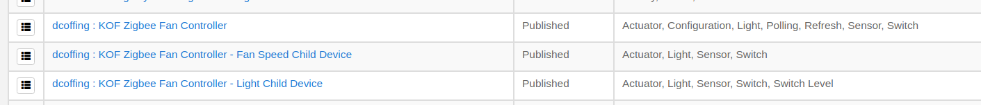

Hey guys - I am very new to ST and I am trying to trying to add my new Hampton Bay fan, and I can get the Device Handlers added (using Github), and I have installed the SmartApp, but I can not get the child items to create. I have tried “deleting them”, and hitting refresh twice, but no luck… any suggestions?
I just tried to install KOF Zigbee Fan Controller the fan and light child devices
as device handlers.

Update - forgot I had to go to IDE & add the handler back to the device
