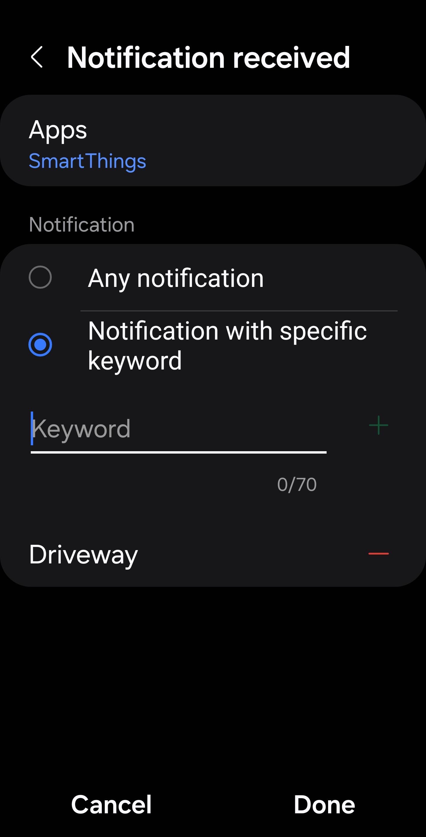

No , not just the SmartThings global sound, there’s a bit I added further down that describes custom sounds per event. I have a custom sound for my driveway sensor
