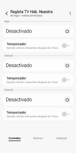

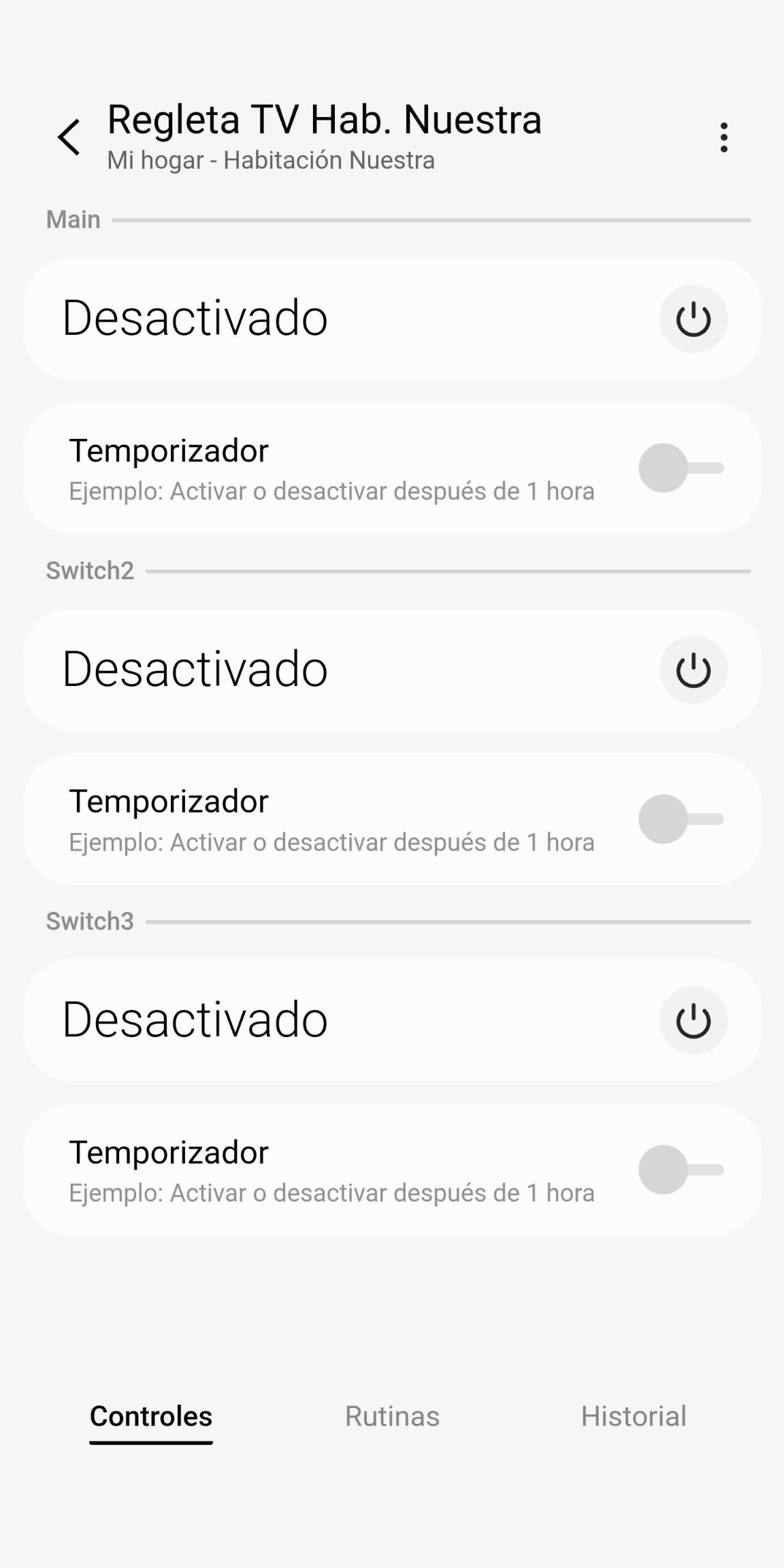

taking advantage, is it possible for you to adjust the order in which the swtichs are displayed? They appear as main, switch3 and swtch instead of main, switch2 and switch3
This is a known App issue with all multi-component devices.

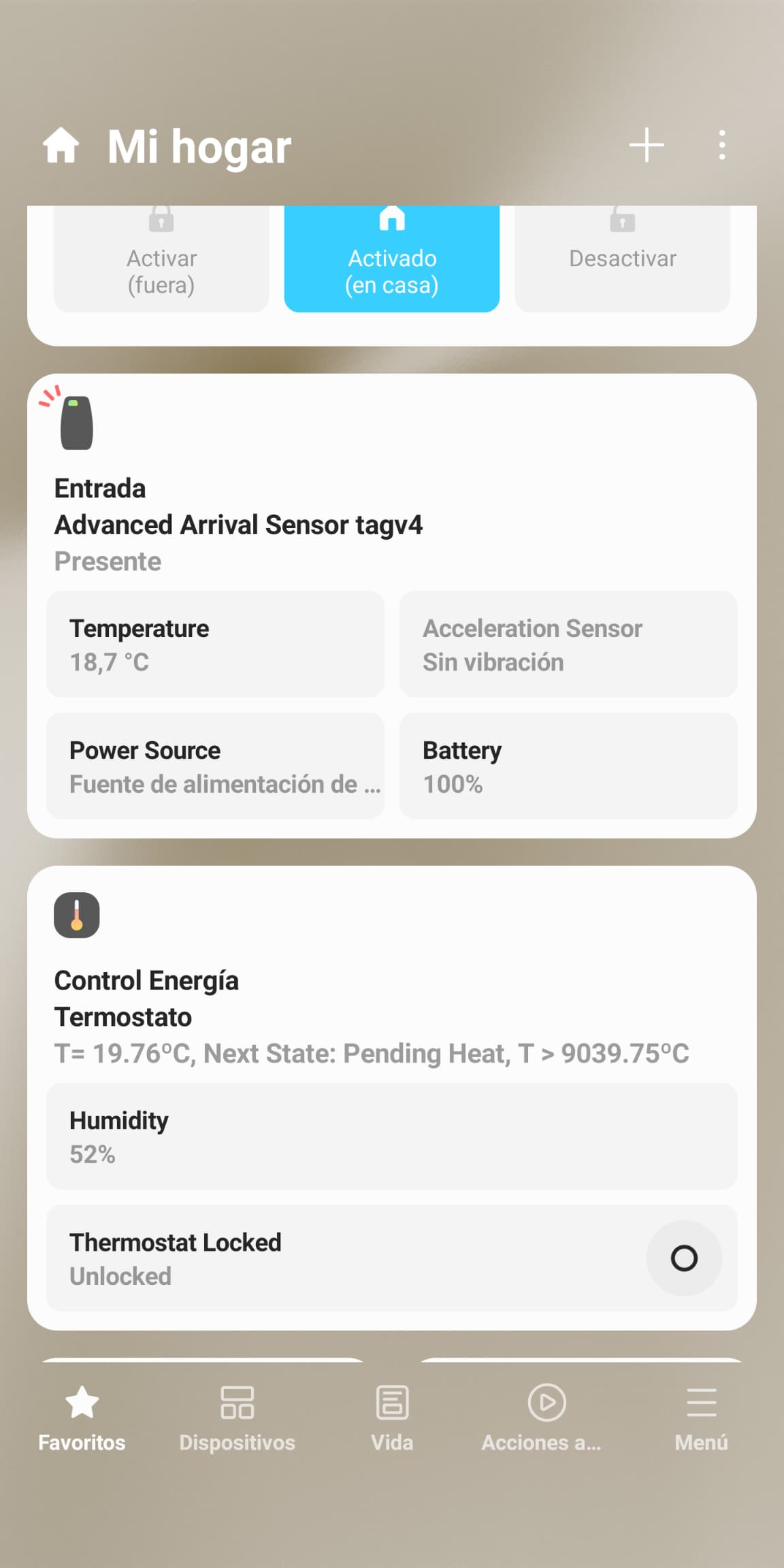

I have made one of them Zigbee Multi Switch Zemismart Mc and it looks like this.
The switch does not turn blue when it is activated, only the name change to Bold type and state name changes.

Using a custom presentation, VID, for multiple tile sorts the switches in the details view

a layman’s question… wouldn’t it be possible for the name to appear at the top without any activation button and the others appear at the bottom?
The Regleta TV would also appear inside the gray box, the same as what appears on switch2 and 3. And it wouldn’t have the trigger button at the top, but in the front, as well as the others

switch2 did not become bold when activated. Yours turned out nice (the print you sent).
