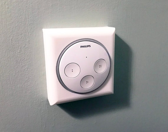

There’s Phillips hue dimmer and tap if I could make a custom panel to hold them so that’s an option. Such a shame the wallmote didn’t work out as I thought the build quality was good.
There are now several cover plates made for the UK that will cover the existing switch and hold a Hue brand dimmer switch or Tap on top. :sunglasses: or of course you can make your own.

There are also some made for Tap, although these are more easily found on Etsy.
I like this one for style:
But there are several. At Etsy, many items are made one at a time on order, so may cost more and have slower delivery than factorymade versions. But it can still be a good resource.

If I went with the dinner I’d need four of them to fully control the each zone so four of those plates side by side wouldn’t look right. Where if you had the remotes nearly touching each other they would look better.
Do you know if the tap has dimming on each button. :thinking:
Everyone has their own aesthetic preferences. :sunglasses:
That same Etsy seller does a four gang version for the UK
The point is just that there is quite a bit of demand now for this type of product, so you may be able to find one you like. Or you may have to make your own.
On the tap, each of the four pressable areas represents one scene in the hue app. No dimming.
