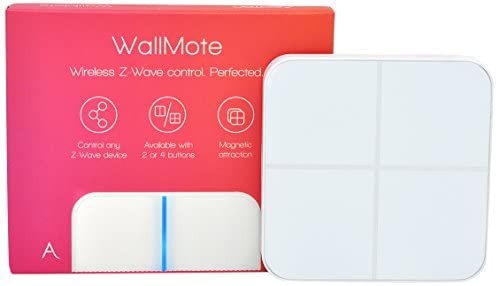

But, yes, sure. If you’re willing to leave the original switch in place, maybe covering it with a box cover, there are lots of battery operated devices you can put on the wall. The one that looks most like a regular switch in UK would be the aeotec Wallmote or the Popp controller. Both cost more than the smartthings button, though. IKEA also has a couple of battery operated devices in their Tradfri line. The product description they say it needs their own Gateway, but it doesn’t: you would be using the smartthings hub instead.
